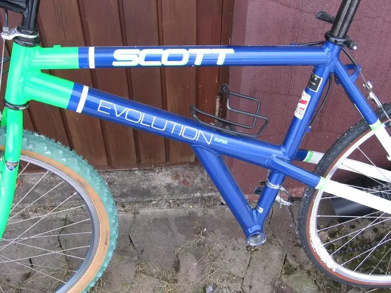

I could get this bike, but problem is there are no threads in bottom bracket.
There has been but they have come out with bracket.
Is it somehow possible to repair?
Frame is in very good condition.
You will have to find a local frame repairers in your area,they can rebore the tube out and press a new alloy b/b shell with new threads in.
Its..
Its a pretty straightforward job for a framebuilder..
i got a quote off BOB JACKSON in Leeds (UK IM AFRAID!) to do the same
job.. Think they put a sleeve insert into the bb shell and they are
supposed to be a good, strong fix :D
If it was normal BSA threads you maybe lucky it will go with italian threads. The diameter is a big larger for Italian so you can bore these maybe with a good device.
Otherwise like said before, use a mavic BB.
good luck.
Martin
