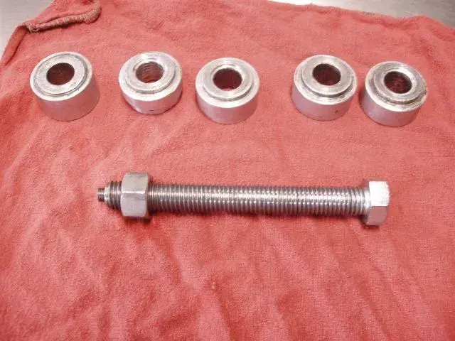

the old hammer method works well, but if you can get your hands on one of these, even better
