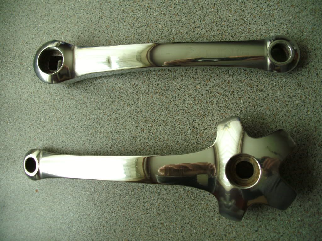

Here's a set of cranks I did..
And after treatment.. :
I can see your belly in that reflection....I thought you were thin for some reason :lol: :lol: :lol: :lol:
I can also see a large french stick to the left of the reflection as well....this helps explain the belly :lol: :lol: :lol: :lol: :lol: :lol:
Pmsl......this is making my ribs hurt this laughing :lol: :lol: :lol: :lol: :lol:
