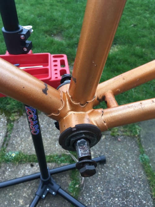

First thing I decided to do was have a look at the headset. the headset and BB both feel completely devoid of grease, but I'm not sure on splitting the BB yet (will watch a vid for that) - I'm hoping its a british thread so I can just replace it.
The headset was easy enough to split, although I have found thread damage to the steerer. Managed to dress it off a bit using the knurled nut as it came off. The top doesn't look perfectly round (of the locknut), and the bearings are probably shot too:
(a lot of the liquid looks like water)
I also took some measurements so I can start hunting for used bits, on here or ebay. Will be looking for kit to single speed it for commuting. I'm not going to do anything paint-wise until its mechanically sorted though. Any advice, pointers, or thoughts most welcome :-)

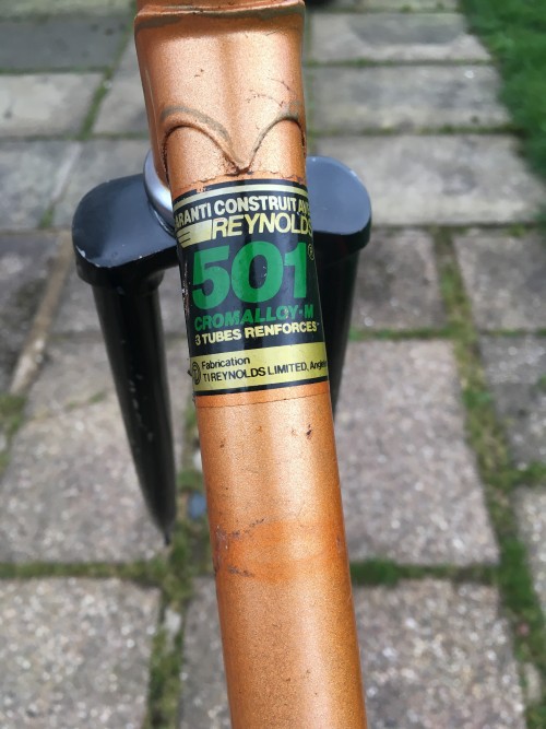

Is the seat post 26 or 27mm? Will give a better idea if it's 501 or 531 tubing.

I measured the seatpost twice (along and across) and got 25.6 and 25.8mm. This was using a cheapy set of ebay verniers so perhaps not the most accurate!
I also make the diameter of stem I need at 22mm which is going to make things interesting!
Good colour combination :)
Measurements sound about right for the 501 labels.

BTW, if you do need to give the BB some attention, just take off the side opposite shown in your pic (i.e. leave the lockring side alone and pop out the spindle to clean up and re-grease.) Will make life much simpler as you won't have any pfaffing about with adjustment after you put it back together.

Given that your seatpost measurements were 25.6 and 25.8mm are you confident the stem is 22.0? Perhaps if you have another bike it would be worth trying the stem for size. If you do need a 22.0 I'd find the right size one rather than try to file one down. Would defo replace the bearings caged or un-caged will be fine
I've double checked the measurements, its definitely a 22.0mm stem, and the seatpost is a 25.8 (thats what I'm going to order anyway). The seat tube appears to be ever so slightly off from a perfect circle, I wouldnt be surprised if - at some point - someone has attempted to batter in the wrong size post.

Today I moved onto the bottom bracket. Although there wasn't any play in the axle it felt terrible, so had to be stripped and investigated. The adjustable cup came off absolutely no problem, however you can see from these photos that it's not a pretty sight:
Yuk! Cleaned up ok though to be fair, and the adjustable bearing cup appears to be ok as does the axle. The good news stops there though - that fixed cup isn't going anywhere in a hurry. I measured it at 36mm across the flats and acquired a spanner, which is fractionally too big. I will get a 35mm tomorrow and try again!
My other option is to leave it in the frame and replace the bearings and reassemble everything. I tried this with fresh grease on the old bearings and although it was a marked improvement it was still pretty rough. Ideally I'd be able to remove the fixed cup and fit a standard sealed BB, but I don't even know if its an English or French thread yet. More to follow!
No markings on the bottom bracket at all?
The ideal spanner is a proper fixed cup spanner which is flat and encircles the whole cup. On really stuck cups I reinsert the adjustable up put the spanner on then a piece of wood across the spanner and clamp it all in place then I can give it a good whack with a mallet. Alternatively I have used a massive monkey wrench in the past too with good success, have to be very careful to avoid paint damage though.
