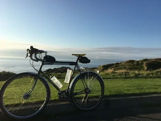

The Thomson one was a set back version, the current one is a gipiemme item. I don’t think it’s bent. In any case i’ll be swapping it out for a Nitto s65 seatpost in the near future.
Another photo from out and about earlier today.

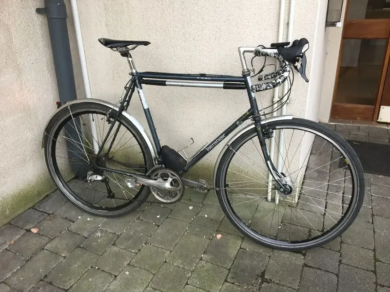

I’ve got a nearly identical Nigel Dean world tour, also 531ST, waiting in the wings. The Nigel Dean is in much better condition, much more presentable.
Current Build List:
Frame: British Eagle 531 ST
Fork: British Eagle 531
Headset: Shimano 105 perhaps. It’s grey.
Stem: Nitto Technomic 90mm with about 250mm length.
Handlebar: Nitto Noodle M133 48cm heat treated
Bar Tape: Cycology velo Tattoo
Bar caps: Nitto.
Brake Levers/Brifters: Shimano Ultegra 6703 / 6700
Brakes: Shimano CX-70
Front Derailleur: Shimano Ultegra FD-6703
Rear Derailleur: Shimano Deore RD-M591 SGS
Rear gears : Shimano Ultegra 10sp CS-6700 12-30
Chain: Shimano Ultegra 10sp CN-6600
Cranks: Shimano 105 FC-5703 170mm 50/39/24 (24t is a TA chain ring)
Bottom Bracket: BB-R60
Pedals: PD-6500
Rim: Rear Kinlin XR31-T 36h offset
Rim: Front Mavic A719 36h
Hub: Rear Shimano ultegra FH-6600
Hub: Front Shimano Dynohub
Hub Skewers: Shimano Ultegra
Nipples: Brass
Spokes: Sapim Double Butted
Tyres: Schwalbe Marathon Supreme Evo 37-622
Tubes: Schwalbe
Saddle: Fizik Antares
Seatpost: Gipiemme 27.0
Mudguards: SKS Blumels 35mm wide
Front light: B&M Cyo-T senso premium
Rear light: B&M μ (mu)
Navigation: Garmin Edge 530, out front mount.
Mini Frame Bag: custom made by Rogovbags on Etsy. Contains spare tube, patches, first aid etc.
Pump: SKS
Bottle Cage: generic
Weight: 13.0Kg
