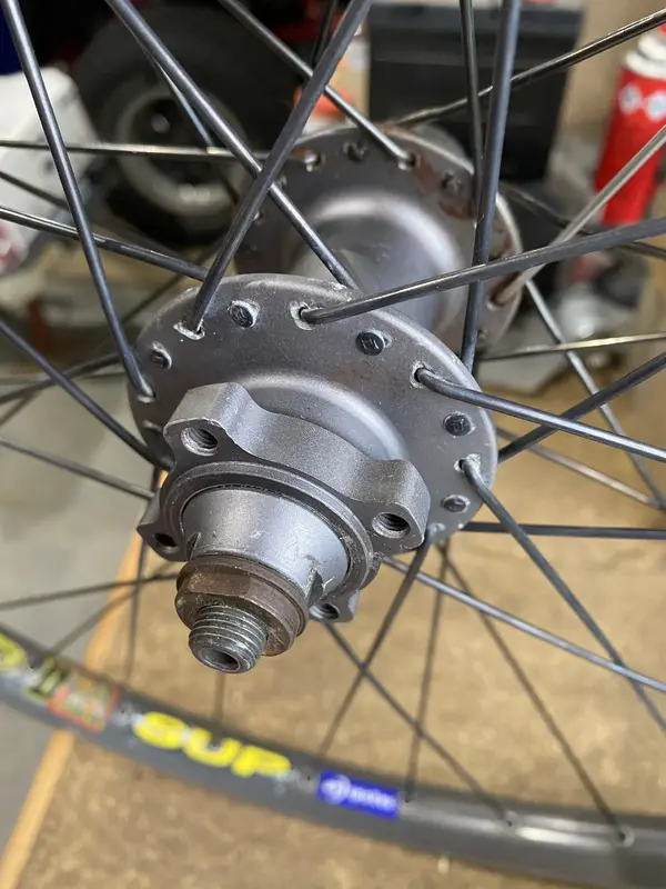

I have this 4-bolt rear hub on my 98 FSR Pro, but it has no markings.
I doubt its orig, as the bike have XTR v-brakes only and no sign of a disc being mounted on the hub. The front hub is a Formula 4-bolt that runs smooth as on the SID 100 forks.
The rear is buggered (no engagement, rusted internals, etc.) but has sealed bearings, so I assume must be decent.
It needs a rebuilt, but I'm not sure it its anything worth saving or just replacing.
Thoughts?

Scratch that idea. Seems no one knows what it is... and... no level of effort can get the rusted freehub off. I've almost buggered a 12mm impact hex key trying!!!
So plan B is to find a replacement disc/non-disc, 135mm, QR 36H rear hub, replce the few buggered spokes and rebuild.
Any suggestions for something decent and maybe loudish (I like being heard with my Ibis Ripley's Tune hubs)?
Not that it really matters now, but if just to appease curiosity.....
I would say that hub is a Cannondale Coda Expert (more than likely manufactured by Formula for C'Dale and was OE on mid range models) that has been rattle can'd silver........
As a hub I'd say it was ok, nothing particularly special, So don't sweat if it ends up a paperweight or to hold the binbag down 8)
