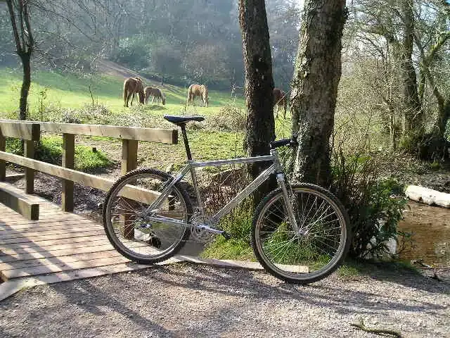

This is how my Pace would have looked if I had made it on Saturday.
Spec now is;
Frame: RC200F6
Fork: RC30
H/Set: Mavic 316
Stem: Syncros Cattleprod
Bar: X-Lite 540 pro Ti
Grips: Kona Foam, grab on style
Brakes: XT Vee front / XT Canti rear
Levers: XT RF+ combined
Front mech: Deore XT
Rear mech: Deore XT
Block: 12-23 7speed
Chain: Shimano HG90
Cranks: XTR M900
Rings: Pace 46 Shimano SG 36 Shimano 26
BB: BBUN72
Pedals: XT SPD with Exus Ti Axles
QR's: Ritchey (Salsa rebranded)
Rims: Mavic X517CD 32h
Hubs: XTR M900
Tyres: Tioga Hound Dawg Kevlar
Saddle: Flite Ti
Post: Ringle inline
Weight: According to bathroom scales 22lbs.
The main changes are it is now rigid and has the Mavic headset.

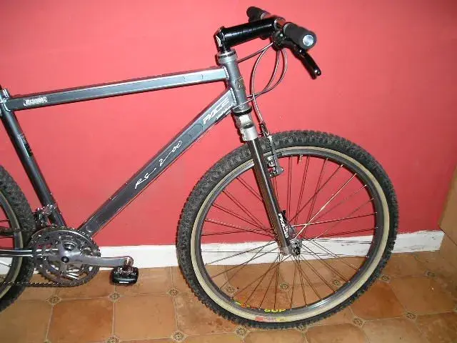

Lean as a racing whippet.
Can we have a front-on pic please?
How much weight do you think you saved by switching to the non-bouncy forks?
