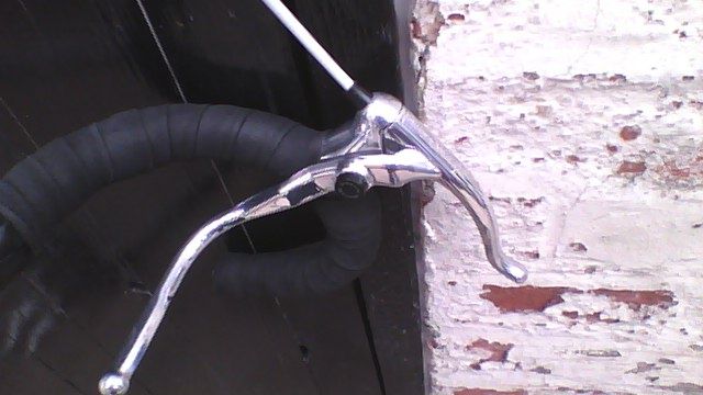

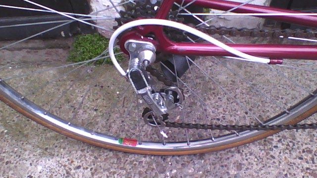

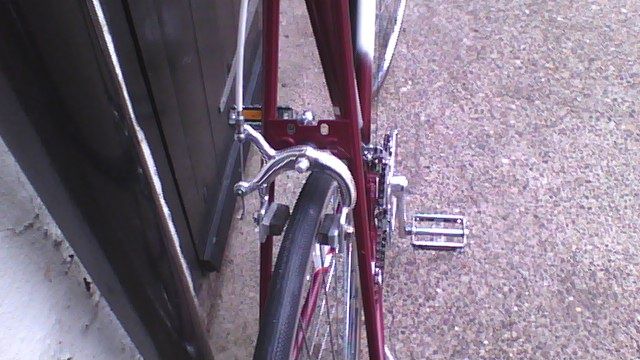

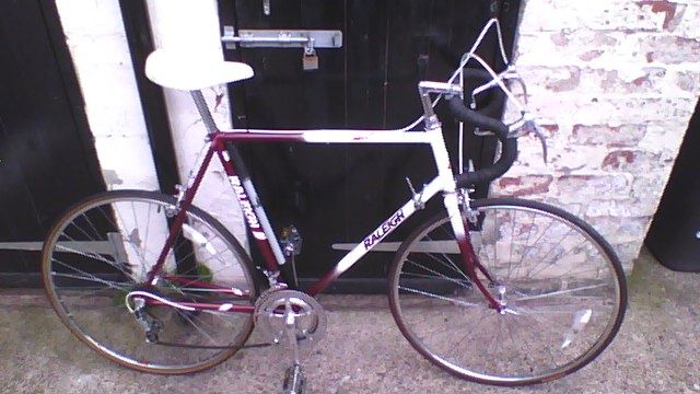

Well finished the bike this morning only thing left to do is true the wheels,the back I managed to true myself but could do with a bit more tweaking and front one could do with more tweaking to,all new gear and brake cables and handlebar tape,I have polished the alloy parts to a mirror finish,but I'm now buying another bike in a larger frame so the wife has told me this one has to go or I don't get the other bike,so just wondering how much it is worth?heres some pictures. [/URL

Used wet n dry sandpaper then used autosyl metal polish did all by hand spent a full day just polishing all the parts,just been out for a spin on it absolutely loved it.
