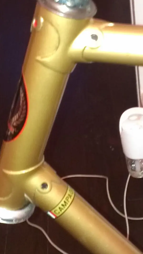

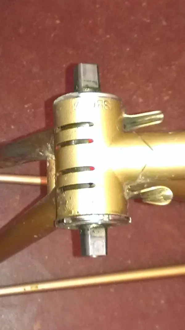

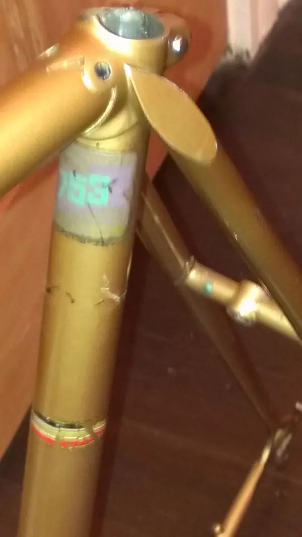

im the new owner of an old raleigh ilkeston frame in its original gold paint with frame number sb664 and having read cloonaghpats thread on his rather lovely sb676 thought id maybe attempt one myself given the amount of knowledge that appears to frequent these pages.the bike is currently partially stripped as a cracked seat clamp lug is to be repaired at Argos and im considering stripping some blistered paint showing signs of rust from bb shell.this aside im hoping some tlc will prove sufficient as original paint/decals are battered in bits but have tons of character.

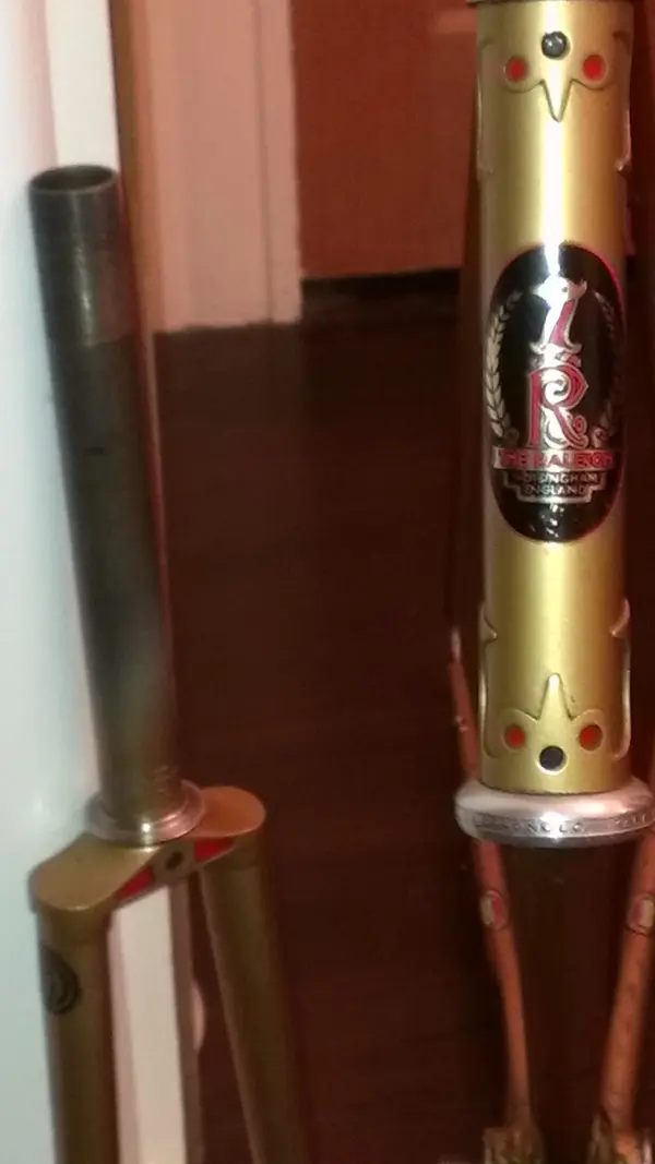

the 'to follow' photos will hopefully show some detailed lugs my untrained eye has never seen on an ilkeston bike before and noticed fork steerer tube is stamped JH and also has a slightly more detailed crown than the norm although also wearing original paint and sporting matching drilled drop outs? sure somebody will shed some light on my mystery.

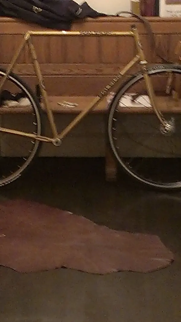

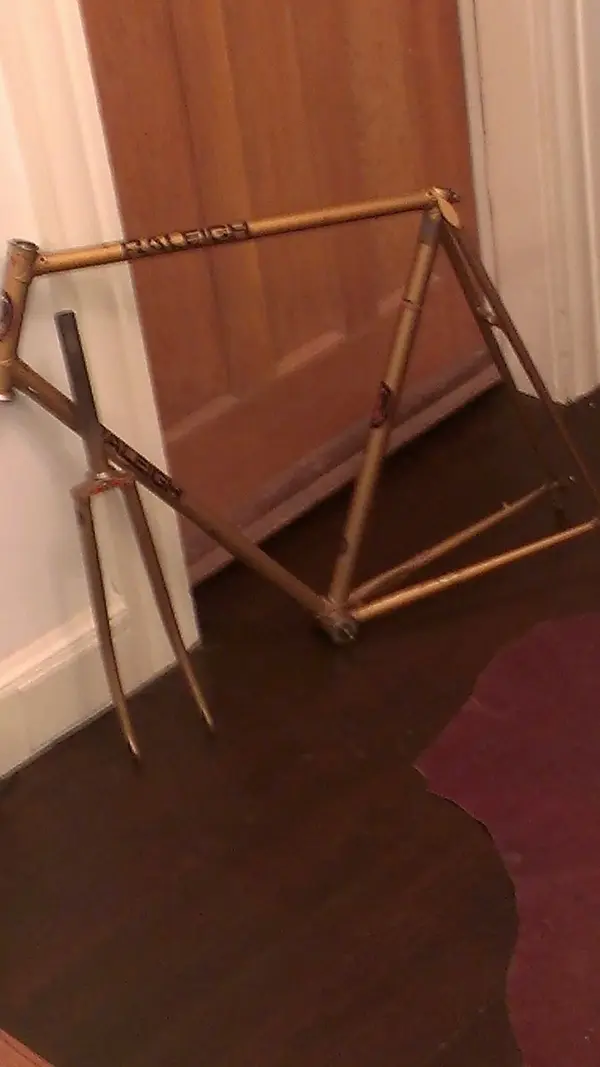

thanks for your reply, id wondered if the frame was originally a tt varient but have measured the toptube at 56.5 c/c on a 61 sized frame. im likely wrong on this but had always thought tt frames would be 'longer' to allow riders to stretch down and be more aerodynamic and 56.5 seems fairly standard?
ive hopefully managed to add a couple of photos of the frameset on a pair of 700c wheels to give an idea of clearance, again to my untrained eye all looks normal but not sure how much space wouldve been the norm?
guess our interests back in late '75 wouldve still been similar though, can only imagine a 14yr old boy wouldve spent most of his time dreaming of breasts, at 3-4months old id probably not recognise much else?
cheers,
andy

Thanks for the extra photo's :)
It's the gold that has me thinking.......Raleigh used a gold colour lacquer for their early lightweight frames to save weight, their hour record frames came in gold lacquer as far as I remember.
Other TT bikes also came in a silver lacquer which was also a weight saving over more normal paint finishes, I guess the most famous I can think of is Martin Pyne's TT bike.
Your frame has guides for a 10 speed though :)
Hopefully someone with more knowledge than me will post :D

LUGS - Raleigh sb664
Lugs have a certain look of the Capella about them - those being a Carlton lug, which is no real surprise as the SBDU did (at least in the early days) have ex-Carlton guys building there.
Vagner fork crown.
