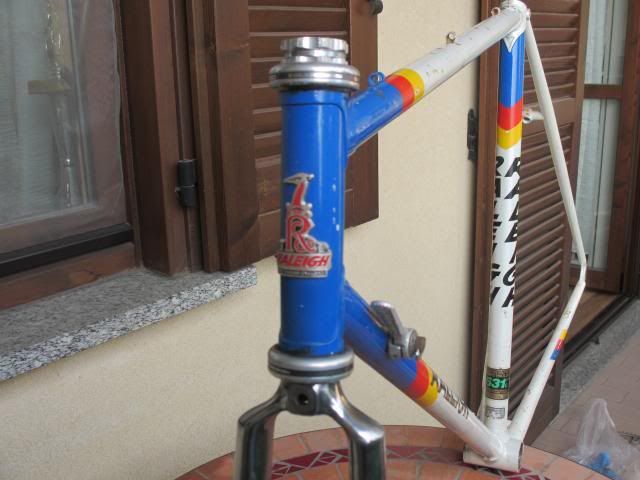

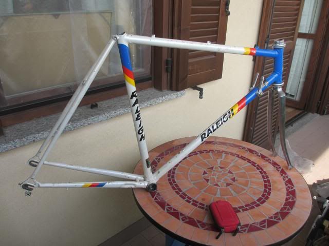

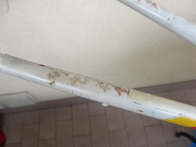

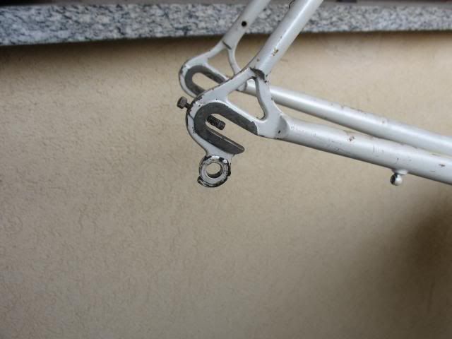

These pictures were taken today (April 5th, 2014) and I need to figure out what to do next with it. The frame number indicates a build date of August 1984.
Should I re-paint it or should I try to recover the paintwork as far as it can be done in the circumstances? Any tips welcome.
Also, before I do anything with it, I really ought to try to find an original fork, miracle though that might be.

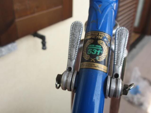

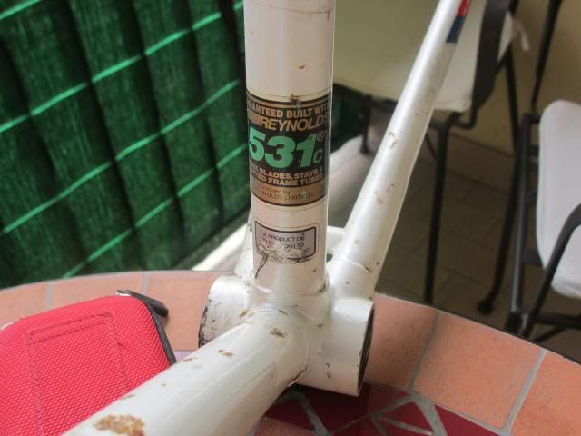

The Reynolds decal on the down tube would suggest it's a 1985 (given that it shows 1935 - 1985)
What is the serial number? (I have found that although the date on the frame suggests one year, the bike sometimes was assembled later...)
Personally, I'd go for a full restoration on the frame and forks, but that's just me!
Thanks Mr W!
I'd never noticed the dates on the sticker! The frame number begins with WL4 so you can see why I thought 1984...
My first thought was simply to recover it to mechanical servicability and use it on the L'Eroica in October seeing as I've managed to get an entry for it.
However, the paintwork is not in great shape once you see it up close and the little rust patches are well established. I am very tempted to just strip it and start again, especially as it is possible to get replacements for the various decals and stickers.
I would, however, like to source a fork that is at least 531 which could be used as a substitute for the missing original and painted up in the proper colour.

Your frame number does mean it's an Lightweight (W, old Worksop stamp) built in August 1984. Like I've already said, it looks like it 'hung' about until 1985, when the Reynolds decal was added, and it was built up.
The above spec's show what forks you need, although I think it mate take you a while to track some down. (note that the drop outs changed from 84 to 85...)
Definitely a 1984 bike then, although the frame number confirms this already
The 2nd link I posted above will detail the original spec, and also what forks you are looking for
To be fair, the chrome ones you have look close...

Yeah, I had a look myself but I've got time on my side in this case. I'm not in a rush to get it done but now that I've had a look again at it today, including some cleaning and rubbing down in a few selected places, there is no alternative now but to strip it back to metal and start with a paint-job.
The chrome ones do indeed look close and may well offer a "substitute" opportunity something more suitable might be found but they're not 531.
