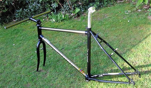

Frame after a clean:

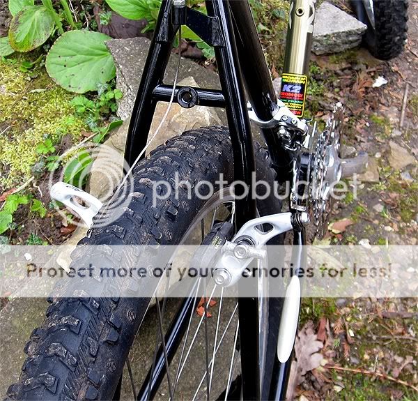

Are the brakes the right way round ? I took them apart and forgot how they go back together:
MAXTHEROTTI":1qreahvc said:
hi and welcome :) :)
pics will help age the thing once you have done your first few posts :wink:

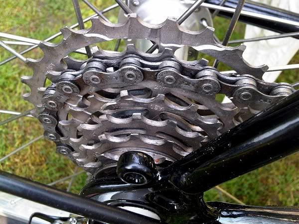

Only thing I have replaced is to put new inner cables in + an old 9 speed chain (it wont hurt going onto a 7 speed cassette will it ?).
One thing that I am totally amazed at is how well it shifts.
I have an XT shod Specliazed mtb that I use 3 times a week... and it doesnt shift as smoothly as this thing (which has been left outside for years :) )

Chain was one lump of solid rust .... 2 mole grips could not even move a single link. So I ditched that and used an old 9 speed chain.
Everything had a thin film of rust / almost mud like coating / alloy white corrosion.
But, bit of autosol ... a fine brass brush for the bolts etc ... and a good clean and GT85 (wd40) .... and things looked almost new.
I was really impressed with how well the mechs came up .. they looked a right state to begin with.
Cables looked horrific ... again, some GT85... bit of scrubbing and some new inner cables and all is smooth as silk :)

I'm ignorant about M-Trax, but from here the top and down tubes look like titanium bonded into cromoly rear tubes and front end, like a Dynatech. I would date it to c1996, possibly a successor to the Dynatech? Is the handlebar ti as well? What do the stickers say?
M-Trax was another sub-brand created to apease our 5* retailers who as solus accounts, could only stock Raleigh bikes.
It was positioned as a step between the mass market products from our main factory, and the Dyna-tech branded products from our SPD division.
Dyna-tech began as a bonded frame product, which was eventually replaced by plasma-arc welded titanium frames.
