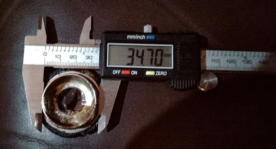

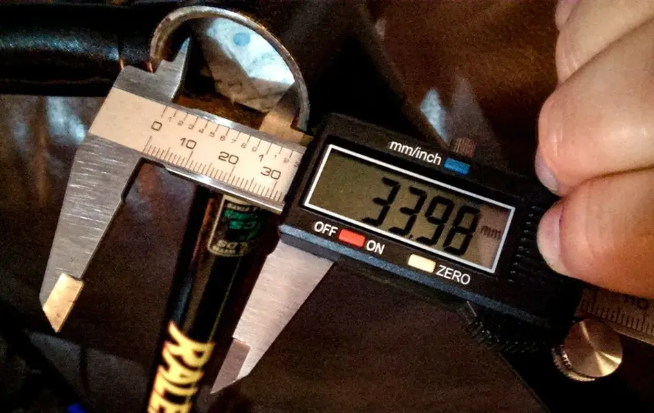

So looking at my old BB I have it as the following: Shell - 68.18 mm - I.D. - 33.98 mm - Cup - 34.70 mm - Spindle - 124.37 mm)

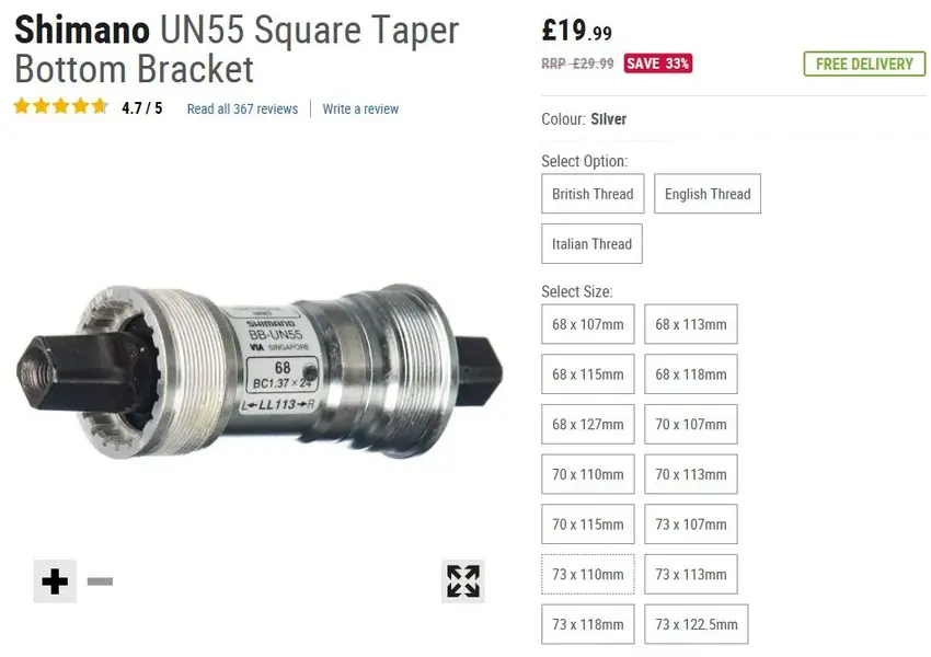

I was thinking of staying with square taper bottom bracket and crank and thinking of this as the BB:
However if I went with the 68 x 127mm wouldn't that put the crankset and therefore chainline out too far? :?:
I then have the worry about the British, English or Italian thread option, I have no idea :|

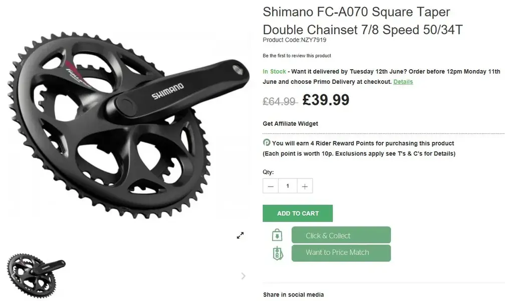

Finally I was thinking about buying this, maybe you guys can spot if it will / will not work with this bike, size, bottom bracket etc:
Edit: - I have just seen this info on the crankset:
Product description - Details
Recommended bottom bracket length: 110 mm
Case width: 68/70 mm
Compatible chain: HG 6/7/8 -speed
I guess that will not work if my spindle thing was 124.37 mm?

bb you bought is much too long. For a double i would expect something from 107-113mm depending on crankset.
Your proposed crank is proof in point but check that is a road crank to maintain chainline as you say.
Good luck
Sorry 68mm shell and English threading ok. Make sure you install correctly as drive side is left hand thread.
Un55 is a great choice but you can find less expensive units if you prefer.

OK so looking at the above, am I right in thinking I can go ahead and buy that crankset and get the 107 or 113mm bb as they are both within 3mm of what is required, I guess its best to have more than less and it would be 1.5mm more each side and I ain't even sure if one would notice that?
I feel like I am close to understanding it, but not quite lol. Maybe a hollowtech II bb would work with the correct crank, maybe the shell is the defining factor.

The top BB with the threads coming out of the axle look like a Sugino Maxy variant. For a modern crankset you need something completely different in length. LFGSS have an unnoficial BB / crankset thread which might give a matching BB for your proposed cranks.
Well, you could get the square taper cranks of your choice and try them out on the existing BB (after putting it back in the frame.) Doing that would tell you pretty closely how much too long the existing spindle is. You might want to check that your existing spindle is symmetrical- i.e. the bearing tracks are equidistant from the end faces.
You need a bit of clearance between the chainstay and the back of the cranks/spider- not too much, and not too little.. I'd say 3mm-5mm.
But really that is secondary to the chainline thing- if you measure out from the centre line of the bike, the mid-point between the two chainrings is supposed to be the same as the mid-point of the sprocket cluster so that the chain doesn't have to go too diagonal if you're in big sprocket/big ring or small sprocket/small ring.
So if you've got an 124mm symmetrical spindle and you mount your RH crank of choice on it and it is off outside the chainline by say 5mm, that should mean that you need a spindle 10mm shorter (5mm each side) So in that example 114mm. (as long as it won't cause the cranks to foul on the chainstays)
