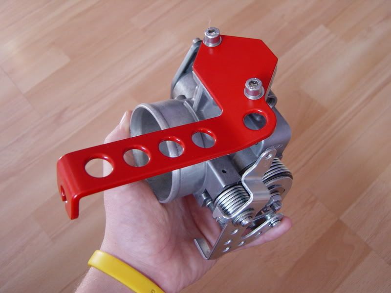

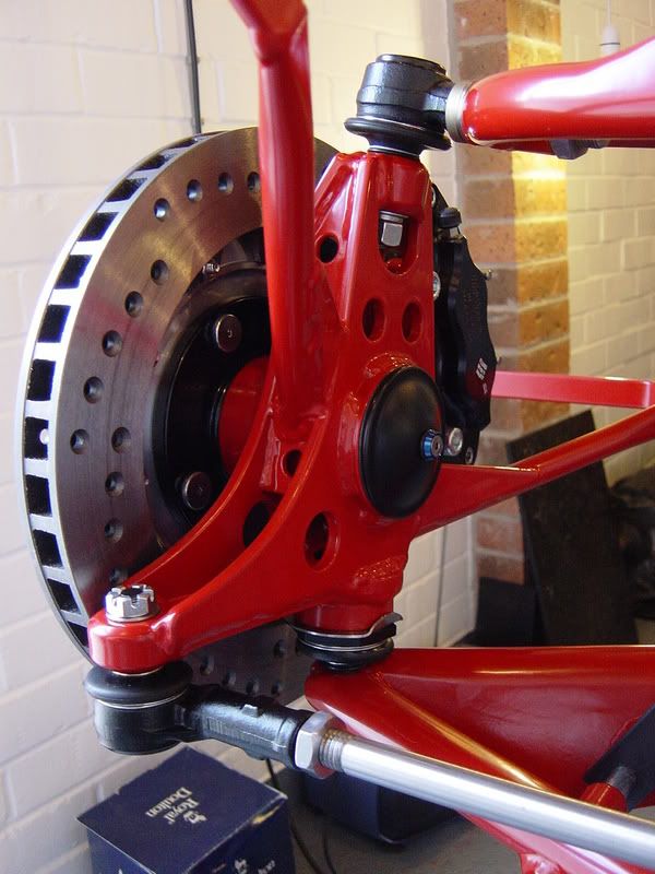

RAL3002 (Carmine red) looks quite dark on a small sample but is nice and bright when on framework :D
Natural, fluorescent & flash (which 'bleaches' it a bit) :
Natural & fluorescent :
Natural (but indoors) :
It's very similar to my toolbox red if that helps ?
Be careful with reds as RAL3020 (Traffic red) looks nice and bright on a small sample but looks quite orangey when on a larger area :?

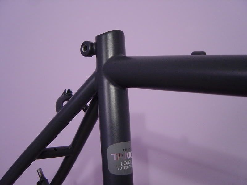

We use 7021 at work which is very dark, my Marin is in 7016 (but satin) :
Natural :
Filament bulb :
WD :D
