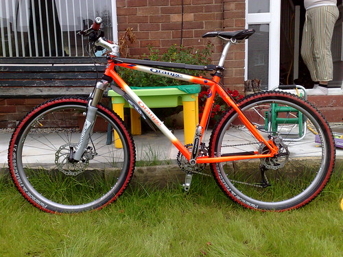

The Orange/white fade respray on my "O" was a pain in the @rse to get right. The 'fade' was done using a small detail paint gun, a car resto mate, and a pack of beers!. A standard gun or Aerosol will result in a splatter rather than a fine fade. It took 3 attempts to get right too.
As for colour, I spoke to my painter today and he had custom mixed mine. RAL colours are normally used to ensure consistency for corporate colours... i.e RAC orange, Focus ST orange etc...
The orange is more toward the red end of the orange spectrum. 1st attempt in Focus ST orange looked more like a Dynarod van!!
Here's the end result... fitting it in around work made it a 2 month wait!

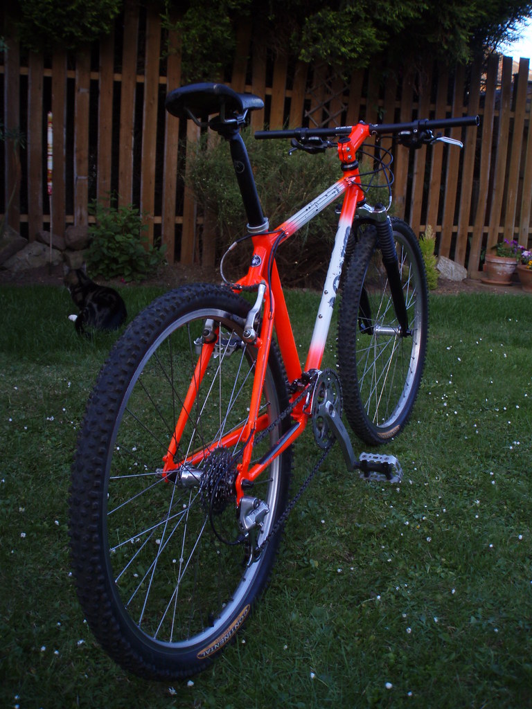

Just to throw another example into the mix.. here is my 99 clockwork.. the orange on this really is day glow.. ala dyna-rod van.. 8)
I'm going to re-finish it, and will be getting the colours matched.. I'm dreading the fade bit though! :shock:

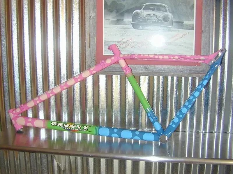

On the other hand, this is apparently powder coated (but I don't think anybody in the UK works to this standard). There's quite a lot of info on the painter's website http://spectrumpowderworks.com/
