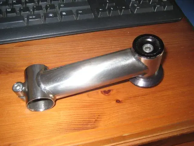

i have a race face titanium stem, i did intend to use this on my current build.
but this will not fit the fork i am using,
this is for 1 1/8" steerer and standard size bar.
120mm long c to c. 0. degree rise
the issue is the wall thickness on my fork steerer is thicker than normal
so this will not fit the inside diameter of the steerer.
however i tried it on a rock shock fork and it is fine.
the stem is in stunning condition.
i am asking for £45 + postage to cover what i paid.
or looking for a swap for another ti stem.

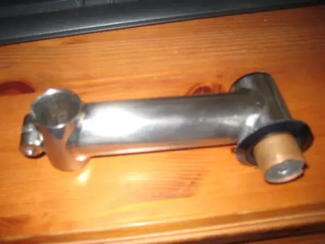

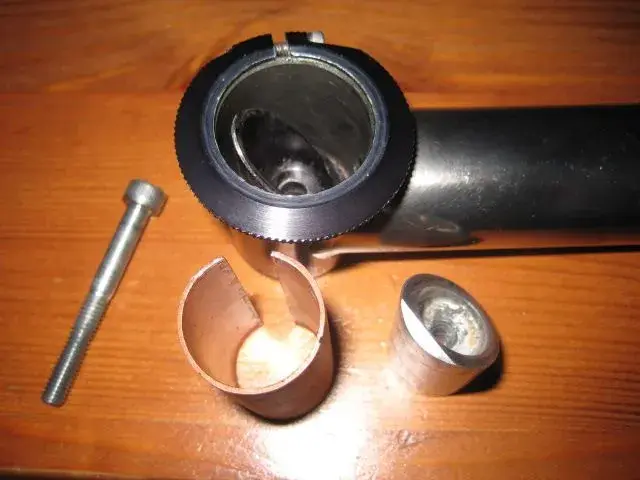

The shim that kase1983 made/fabricated and fitted, can this be removed to enable the stem to fit alu steerer tubes (i.e. one`s with a smaller inside diameter). Whats inside the shim? I believe it to be just an expanding wedge. If this is so, then the brass shim cant be a full circle i.e. it must have a split down it?
Sorry if it`s a bit of a vague description but its many years since i`ve seen one up close.
Many thanks regards James.
i have enclosed a pic of the wedge & copper band removed.
it basically works like a quill stem.

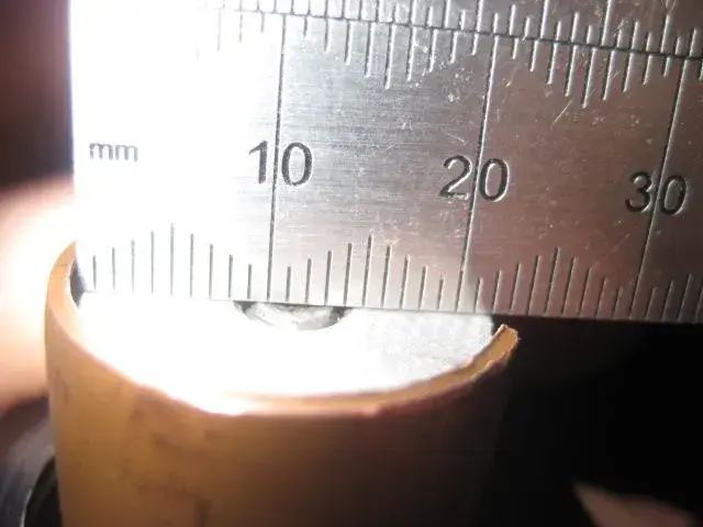

i've also measured the diameter of the wedge, 22mm.

Just been on your Merlin build thread and seen the wall thickness of the fork your using and wow! it sure is a thick guage steerer.
Well the internal dia. of my sid alu steerer is approx 24.5mm now i`ve finally got home from work and had a chance to look.
Whats the brass/copper shim thickness? Looks about 1mm?
