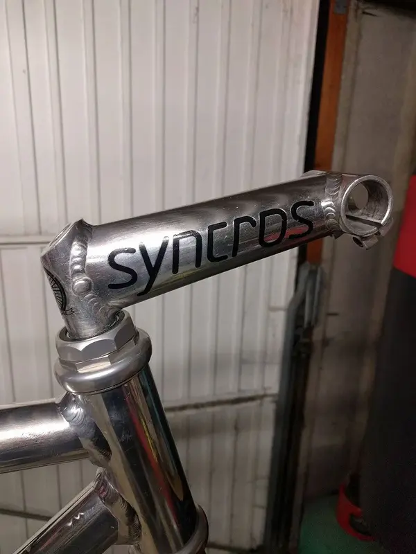

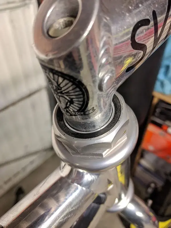

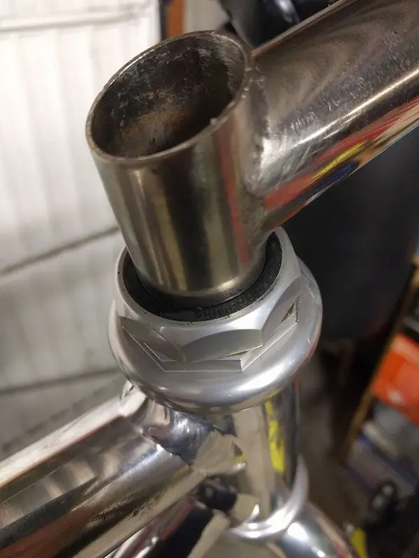

Shim fitted and stem installed. Do you think it needs a rubber o-ring seal to stop any water getting in?
It seems a tighter fit with the correct size stem installed.
Cheers
