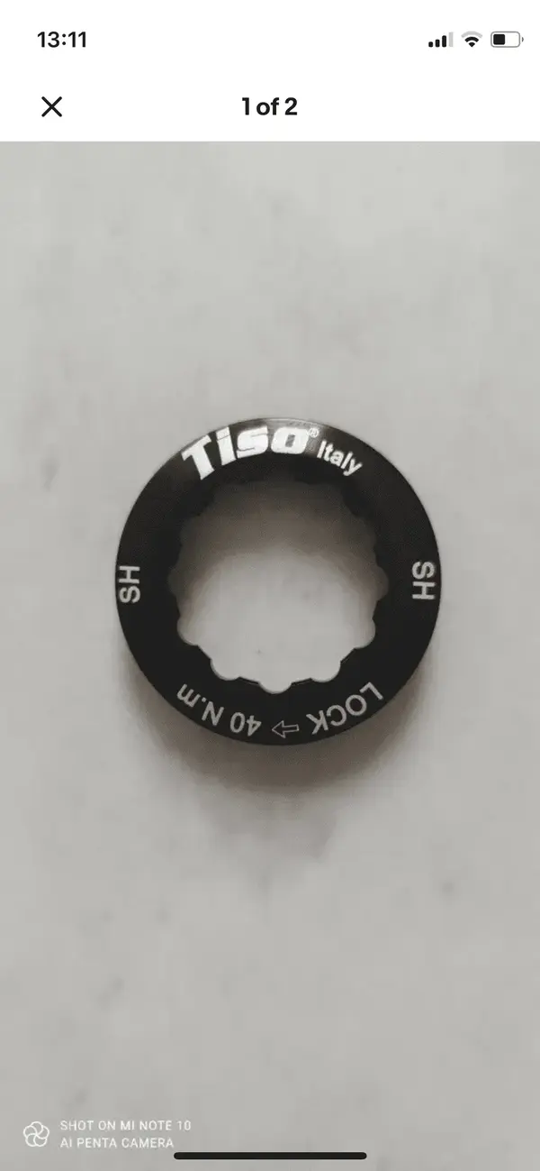

I’m curious to know whether these cassette lock rings are universal for say 8/9 speed shimano compatible cassettes?

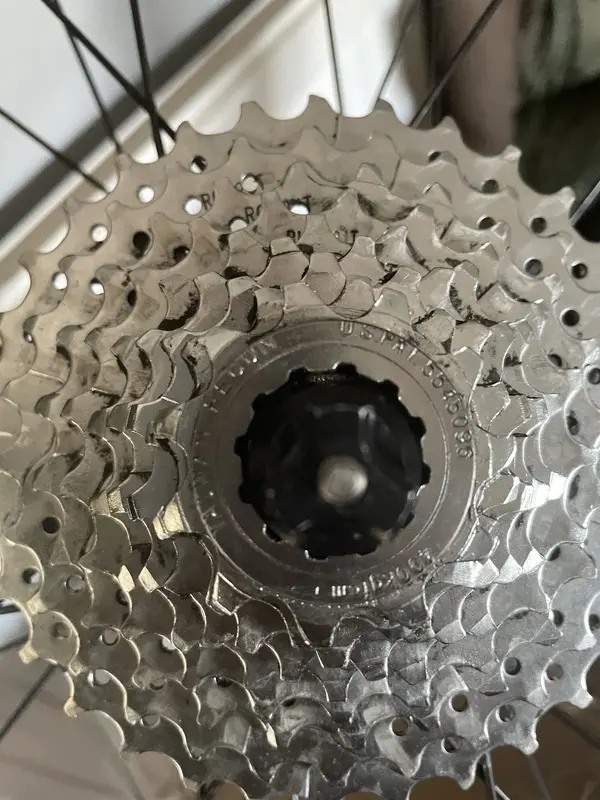

My cassette has 12 notches - I presume these are referred to as teeth?
Would one of these simply replace the one on already?
Or are they specific for a certain speed?
Cheers
Cassette lock rings are pretty universal, only thing you may want to pay attention to is the fact that there's a slight difference between lock rings intended for cassettes with 11 teeth on the smallest sprocket vs 12 teeth on the smallest sprocket.
Ok!
The description of the Tiso says shimano 11 teeth - my smallest cog has 11 so should be ok?
