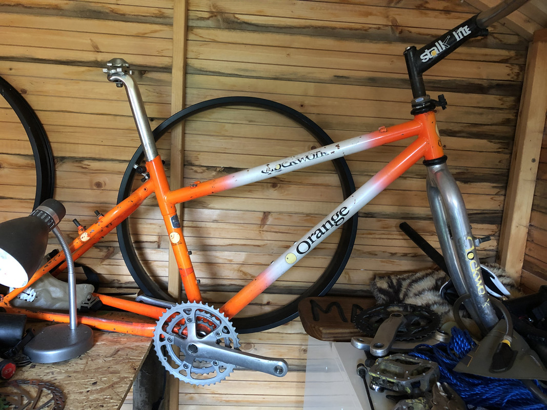

Another update!
thanks to Mr OX for the loan of the die, the xc400 got the steerer cut and rethreaded. They also had a complete strip down and respray as they were a very tatty black and orange, which didnt work with the black and purple theme.
Also a new Ritchey Logic headset was fitted as the old Deore unit was well and truly knackered (didnt fully realise until i put the bottom race onto the new forks, built it up and test rode to find the front end all over the place :facepalm: ....pitted and bent, so chucked in the bin!)
It now feels spot on.....
Frame: 1992 Orange Clockwork 14”
Fork: Marzocchi XC400
Headset: Ritchey Logic 1” threaded
Stem: Unnamed
Handlebar: Orange Alloy
Grips: ODI Attack
Brakes: Dia-Compe Versa C5 front, Deore LX M560 rear
Brake Pads: Shimano
Brake Cables: Jagwire
Cantilever cable hangers: Shimano
Brake Levers: Shimano Deore LX M560, modified with STI mounts removed.
Shifters: Shimano 7 speed
Front Derailleur: Shimano Deore LX M560
Rear Derailleur: Shimano Deore LX M560
Derailleur Cables: Jagwire
Cassette: Shimano
Chain: SRAM PG850
Cranks: Deore LX M560
Chainrings: Shimano
Bottom Bracket: Shimano UN55
Pedals: Wellgo Alloy
Hub Skewers: Purple Unnamed
Rims: Araya RM17
Hubs: Shimano Deore LX M560
Tyres: Macaw Purple
Tubes: Schwalbe
Saddle: Fabric Ladies fit
Seatpost: Polygon Alloy, supershort
Seatpost Binder: Purple Unnamed
