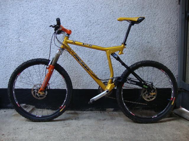

After many years of not using my XP-8, in the last 2 years I have brought it into the 21 century.
upgrades:
- carbon fibre seat post and headset spacers
- Ti wheel skewers
- 9 speed gears
- disc brakes front and rear, both requiring custom made adapters as the Z1 have non-standard spacing
- rear Air shock, much more tuneable, requiring custom made adapter (about 1/5 price of the Risse shock - I did look into that option but £ 250+ for a shock made my eyes water :shock: ... don't forget you'll be stung for VAT as well as duty by customs if importing the shock) .... and before you ask, I have no plans to supply any more. :?
I have fitted riser bars since the photo was taken and I felt I was leaning too much on the bars due to the race geometry, also stiffer springs inside the Z1s.
All in all, it has much improved the ride as well as stopping. :lol:

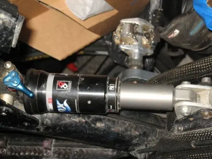

Shocks- my carbon Oz came with the fox RP23, which is a great shock
