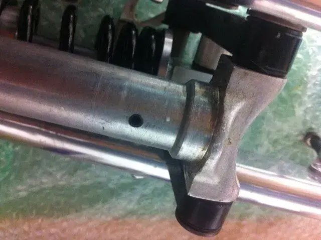

Just so happen to be taking mine apart this evening for a clean up , I have a 1" steerer with a shim for the top and the bottom as can be seen flairs out to 1 1/8th
Hi ,just built a Proflex XP-X works from bits ,first the forks then got the frame and was faced with the same question , what head set and where is the missing bit ,the answer is 1 1/8" cane creek S2 head set and an 1" to 1 1/8" adaptor from the top head set ,it sounds yours like mine is missing this part ,yes hope do a mix and match but at a price ,cane creek are reasonably priced and so are replacable bearing ,you might find more info K2/proflex riders group ,do google , good luck ,if you need more info just ask ,
