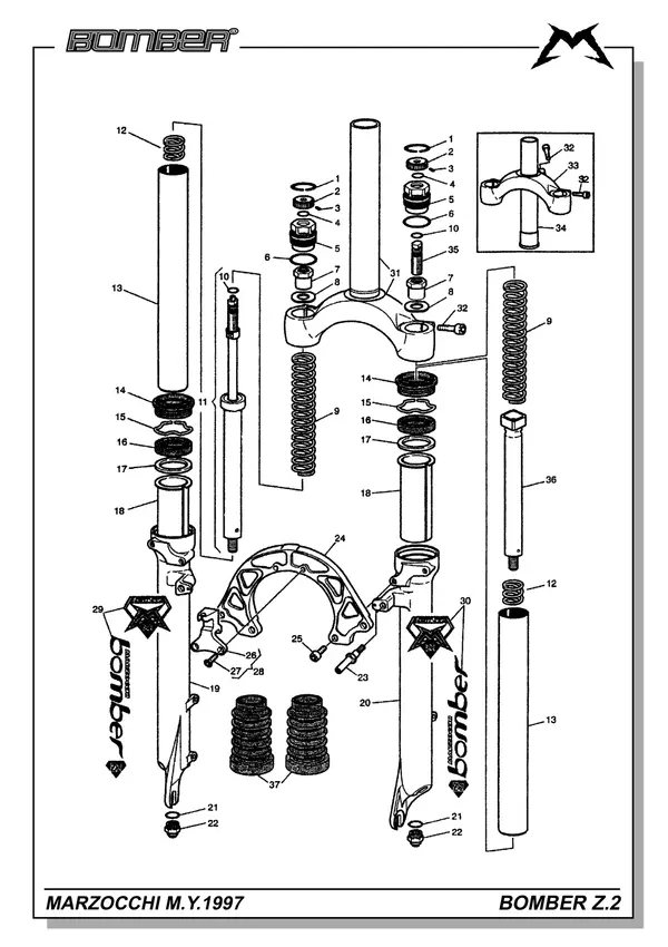

Several times I managed to properly bottom out the Z2's. I think there was a section called the Devil's staircase, and I went totally through the travel and heard a metallic thud as the forks bottomed out.
What can I do to prevent bottoming out the fork travel, please? I've used Motul 7.5wt oil which looks to be right for the dampers. I've got the stock springs and not added any preload. I am about 165lbs at the moment, slightly tubby but within spec for the stock springs. Is this just something to expect with forks from the late 90's?

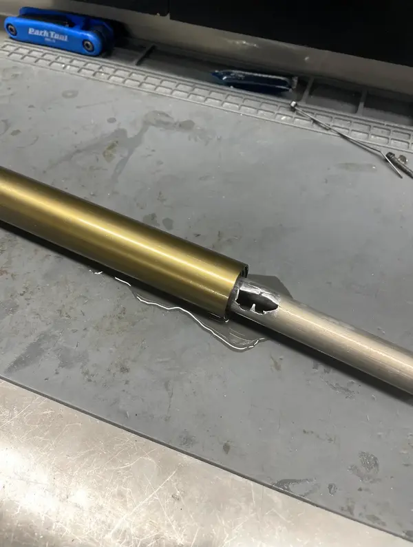

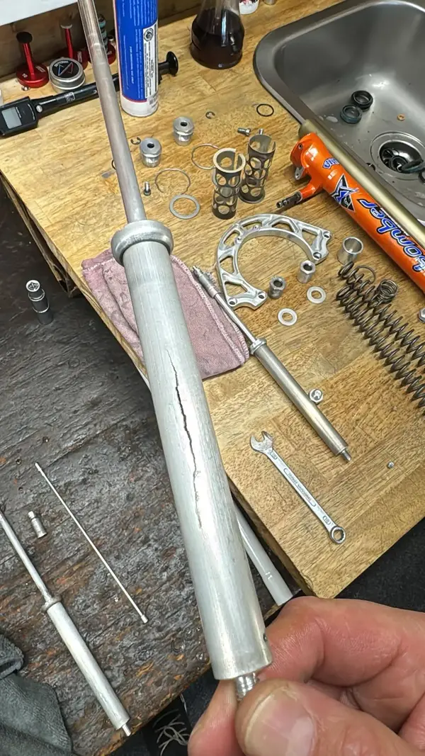

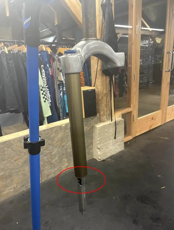

I know it has been talked about a lot in changing oil to change damping, but that is a huge technical fail. Yes, the damping will change (in fact it will be eliminated) and yes, some force will go into the cartridge, but that's a bad idea, because it eliminates the correct spring/oil/cartridge system, means the tire will not stay on the ground and cartridge will be over powered. That's the reason such thinny aluminium cartridges will blow up.
