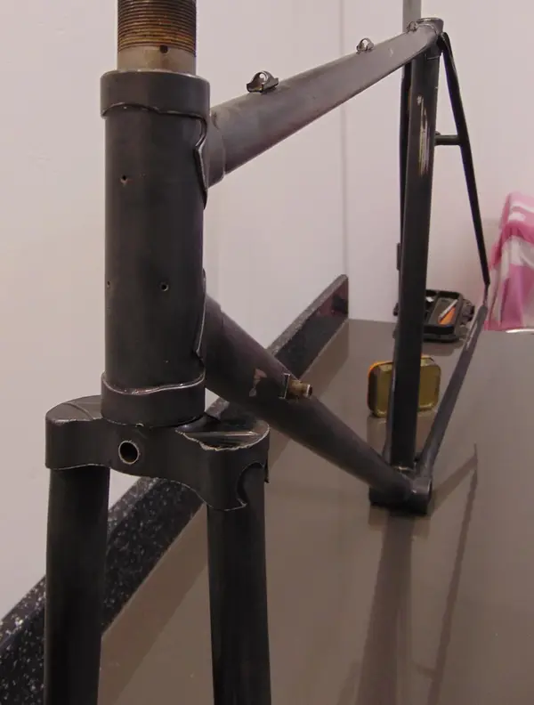

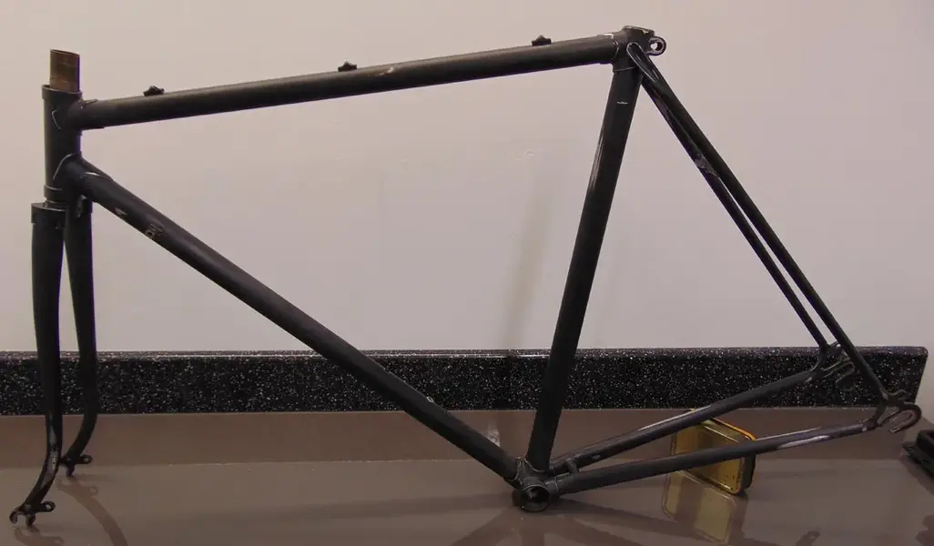

My Mk1 Raleigh Record Sprint restoration progress report. So I have cleaned and checked the frame & forks in prep for spraying. No rust found so thats good for a 30 year old frame. One bottle cage fixing will be replaced and the forks need some adjustment, so not bad for a 30 year old frame. Now it is with Colour-Tech in Dartford for a strip and spray when the decals will be added and lacquer applied. So photos of Davids work to follow.

Obviously an optical illusion but those forks look as though they've been in a crash as look bent......
Indeed, the left hand fork leg looks like its been hit from behind, please tell us it’s just the camera angle before you throw effort and money at it.
David at Colour-Tech is setting them for me. We checked the frame which is straight and does not have any cracks near the front lug which is where it would normally be if in a crash. Bike was found in a garden half buried and of unknown history. Thanks for your comment much appreciated will post pics after the spraying is complete.
