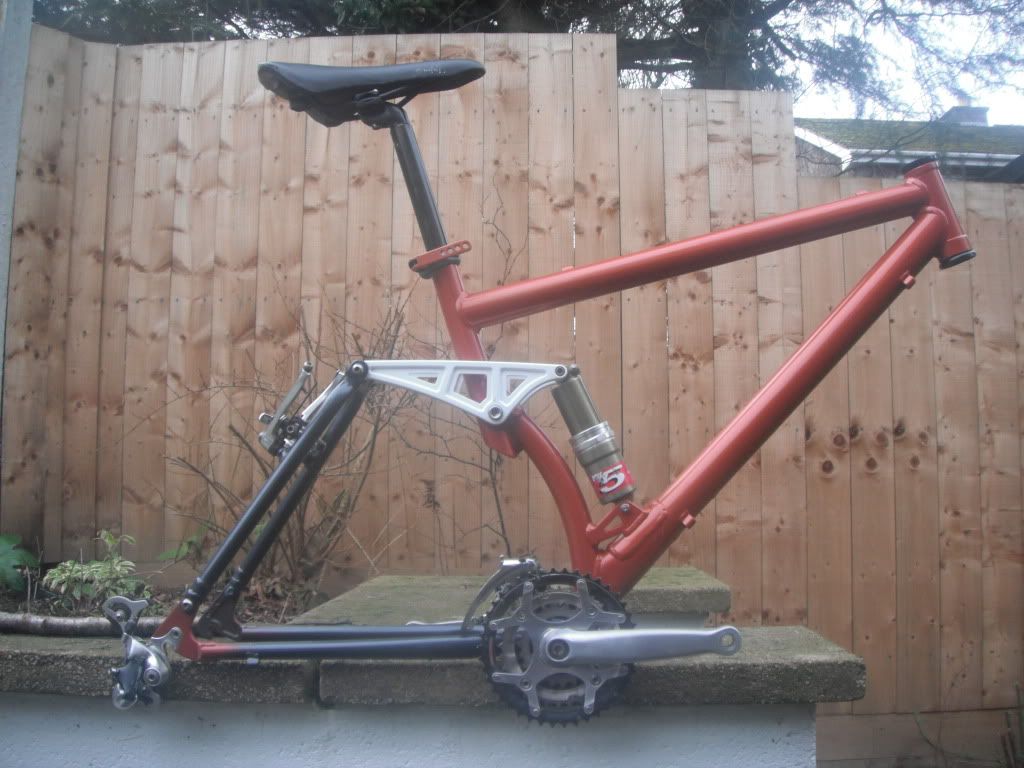

ive been on to carlisle powder coating (never heard of it and im from carlisle!!) and they say £50 to shot blast and powder a mtb frame but not sure if thats a hard tail because my frame is 5 parts!
anyway inbetween that i checked my paint store and found these colours
vauxhall bright copper vauxhall magic grey and a bright white
im thinking it looks ok
what do you think
