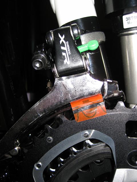

Hi everyone,
A quick question regarding a front mech. I have to mount an xt mech on a freshly painted frame, so no clues on seat tube where the previous
one sat. It's being paired with an xt compact crankset, anyone know
a rule indicating where it should be sited?
Cheers
Craig

Thanks gentlemen, speedy as ever! Legrandfromage,
I'm pretty sure this isn't the first time you have helped me
with the Klein build. Sincerest thanks!
1mm is very close. Obviously that's new XTR, so kinda state of the art. 2-3mm is more commonly considered proper, as it allows for a little flex and slop. I think lower end shimano still has 3mm on the red sticker.
That's M960.. Hardly new, but yeah I'd go for 3mm personally.
