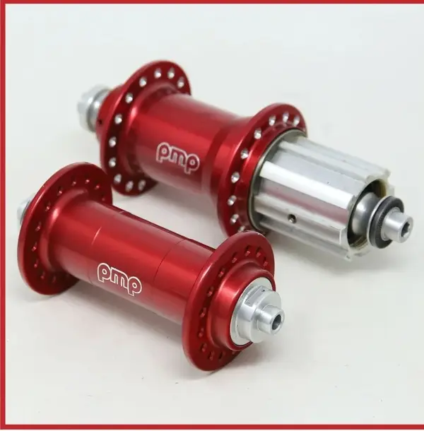

I was wondering if anyone has had experience in changing these freehubs?
I bought a nice shiny silver pair cheap-ish but hadn't realised they had a Campy freehub body.
Luckily I found a cracked hub with a still ok Shimano body on.
Pic for identification purposes only..not mine.
Can't seem to find any specific info and still don't know what all the bloomin' grub screws do.
Any help much appreciated, thank you.

I have the rear hub drawings but I'm not at home now . I can send you when I'll be back after day 25th . As I remember a PMP guy show me how to do it almost 20 years ago in their workshop and it was really easy ( the small holes on the freehub body is made to have access to a small allen bolt that allow removing the freehub I guess ) . I never had to do it but years ago I swapped the rear shaft from 130 mm to 135 mm and it comes very easy .

Sorry for the large delay ... I really forget few times , but now here You have the hub instructions . They are in italian : if you need some explications contact me and I will help to clear the points . I hope this will help You
  • PMP_docs_istruzioni_mozzo_anteriore.pdf
  • PMP_docs_istruzioni_mozzo_posteriore.pdf
