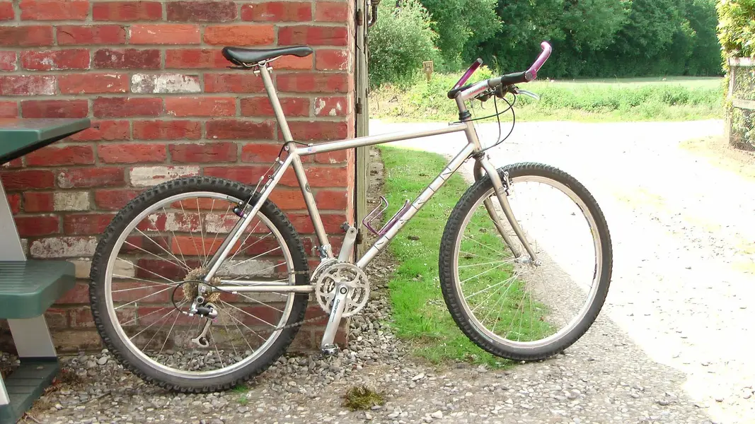

Had this baby from new about 1993 I think. So long ago. having the frame powder coated next week. I had to replace the stem but since then the bike feels ever so twitchy.
Bit of a daft question but why are so many people into restoring their 20 year old bike instead of going and buying a new one apart from the cost.

Not many people ride retro bikes. Walking round norwich yesterday I must of seen 150 bikes, only one I'd say was 'retro' and that was a Marin Bobcat.
Is the length of your new stem the same as the old?
Just look at the picture of your own bike. You shouldnt need to ask really! :wink:
think your pine is more `95 and the retro thing has a lot to do with recapturing youth and for me collecting bikes I admired back then ( I also collect old boxed Corgi cars ) By degree we are all a bit OCD I think but the social side of riding the machinery and meeting up is a great pull as well as the tinkering away in a shed aspect.
Your ride though....the twitchiness is either too short a stem or too small a bike...as a general rule when in the riding position you should be able to look down and see the front wheel axle about 1.5 - 2" behind the handle bars.
Unfortunately if you powdercoat a nickel plated frame like yours it may as well be a modern bike as it will loose its retro nature..new chainset too I see...just my thoughts hope the tech bit is helpful :D

i dont see any great need to get that powder coated, and love the old marins .i biked to 18 miles to work on one for 2 years. until i was given a new cannondale by the local bike shop i raced for :D

I guess there is a fair chance that if it was okay before and the only thing that's changed is the stem then..it's probably the stem
is it the right size? as I can't tell by the pic if it is a genuine marin stem

thanks for the reply guys. The reason I thought about powder coating my frame is because near the BB underneath i have a fair bit of rust stone chips. the old girl is looking a bit scabby now. it not powder maybe wet paint her or would powder coat as undercoat then top coat with conventional paint.
any input welcome

you could get it re-nickled , i have seen a thread on here about it somewhere i seem to remember it costing about £ 85 -90 . which is about the same price as a wet spray
