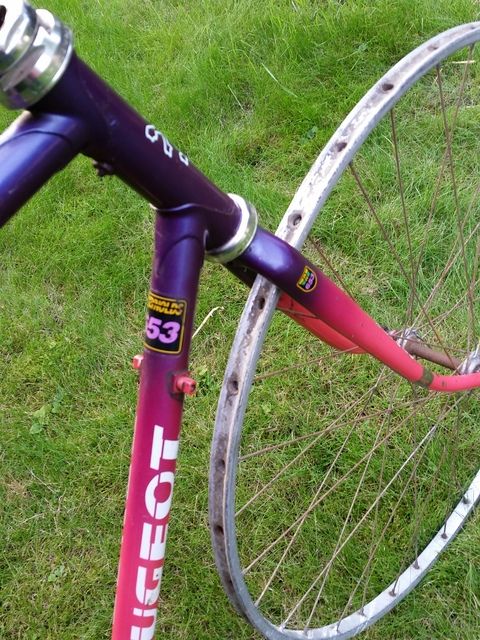

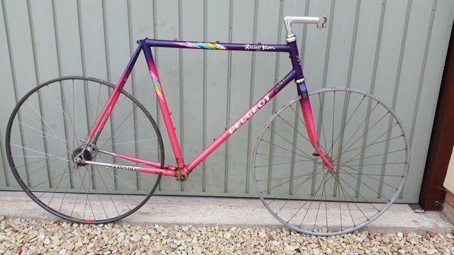

I am new to the forum and am wanting some advice for my Peugeot 653 (Pink/purple) which I was going to sell but now seeing the following they have, I think I will gladly restore mine.
Mine came from the middle of France 7 years ago, luckily I found it through a great French mate who was also able to pick it up for me on his drive from home.
My predicament is that I bought some new Mavic Aksium wheels for it and realize that the rear triangle is around 124mm for the dropout (hub) spacing and the new wheels are 130mm. So therefore I would like to know if the rear triangle is made of Reynolds 753 or Reynolds 653. Hopefully it is 653 steel which I believe can be cold set? I would much rather use modern wheels instead of the old school freewheel.
My frame has the cable guides on the under-side of the frame.
It has a mix of parts and I would like to modernize the bike.

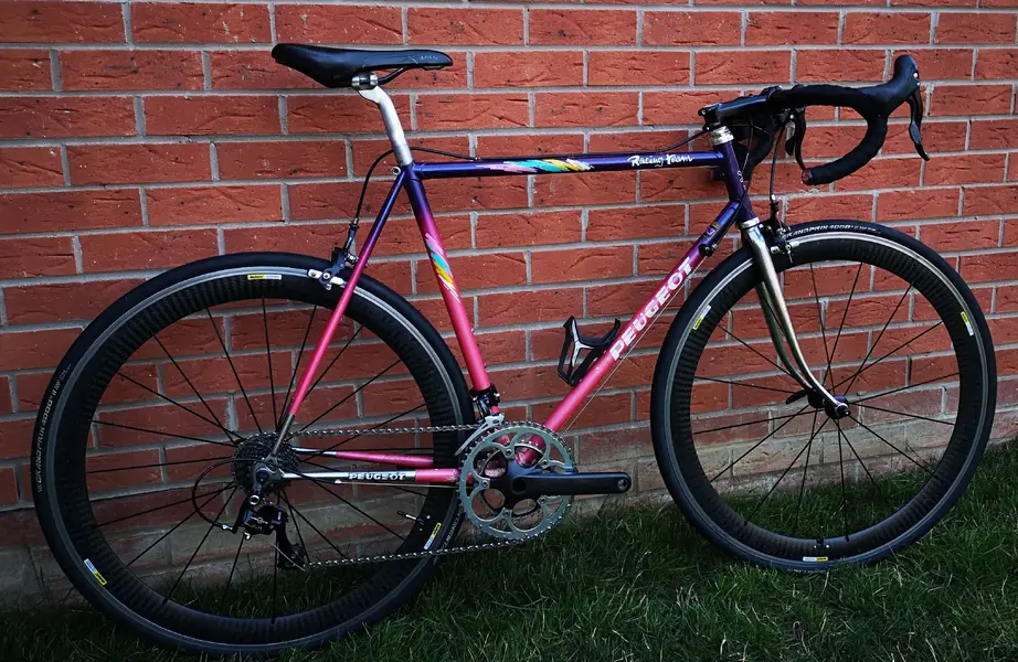

Thought I'd resurrect this thread as I built the frame back up today. Few bits to finish off (bar tape, rear brake cable) as need something to ride as I broke my modern racer last weekend (snapped chainstay going up Hardknott Pass!)
Not sure if I like the ahead convertor, but I have a pair of carbon forks to go on, just need a threadless headset. Wouldn't mind getting hold of a pair of original forks with a longer steerer and installing alongside a threadless headset so I can run a modern setup without convertor.
Anyway, here's a pic!
Finished now - hopefully take it for a ride later today!
looks very good! I've tried headset converters, I think the problem is more the size of the stem than the style - ahead stems all seem to be wrongly proportioned for thin tubes steel frames, especially if they're for 1 1/8" steerer tubes and you've used a converter with a shim. Yours doesn't look too bad though, and I like the combination of paint/chrome/black components!
