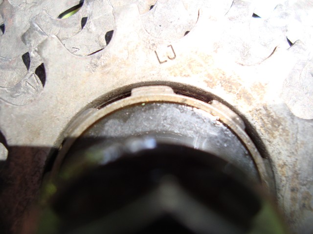

Is it true that on Uniglides, you can turn the sprockets around to get more use out of them? The problem sprocket will be the smallest outer one that is also the threaded lock ring that holds the sprocket set together. Is this reversible? Is the spacer between it and the next sprocket part of the outer/locking sprocket, or is it separate?
Finally, if all else fails - and I realise they're scarce - where would I start looking for new or good used sprockets?

I'm assuming that what you have is a freewheel, as far as I know, there weren't any 6 speed cassettes. As such, replacing it means you just unscrew the one you have, and screw on a new one.
Can you take a picture of what you have?

Have to say, those cogs look in very good shape/well defined.
