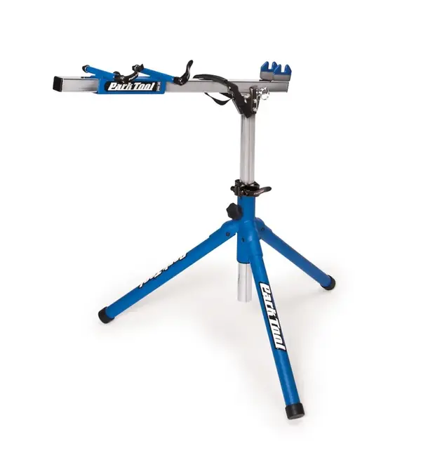

I spotted a Park Race stand (like this)
And managed to get it for 95.00 including postage - postage must have been HUGE due to the weight.
So far so good. I knew that it only had the 100mm and 110mm QR axle block, and so knew that I needed a 10mm axle 100 and 110mm block like this:
but then I realised that the top arm was too short for very long modern Enduro rigs. Grrr. But no problem. I simply measured up the chrome arm with a Vernier gauge (rightly assuming that it would be imperial and not metric, given USA manufacture) and then bought a long section of mild steel square section. Six holes later, two self tapping screws and some filing, I had a replacement arm which can hold both axle blocks, QR and thru-axle, and matches even the longest of long, low and slack as well as short, high and steep. Hurrah. Lovely stand to use, since it has height adjustment and can swivel a wee bit, gives a good non-back-breaking height to work on BB etc, plus very easy to set up gears, which can be an issue with top-tube holding work stands.
