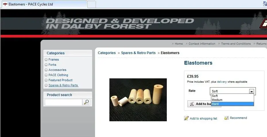

My next question is to do with the front suspension. It's a Pace Carbon Front Suspension, I'm guessing a RC-35(will check later on today) and there is no "movement" on it. When I lift the bike up while keeping the wheel on the ground, the fork would move up but when cycling or after sitting on the bike, it would go to it's lowest point and not move up again. As you can probably already tell, my knowledge on MTBs is very small, so I'd appreciate all the help I can get. Will upload some pictures of the problems later.
