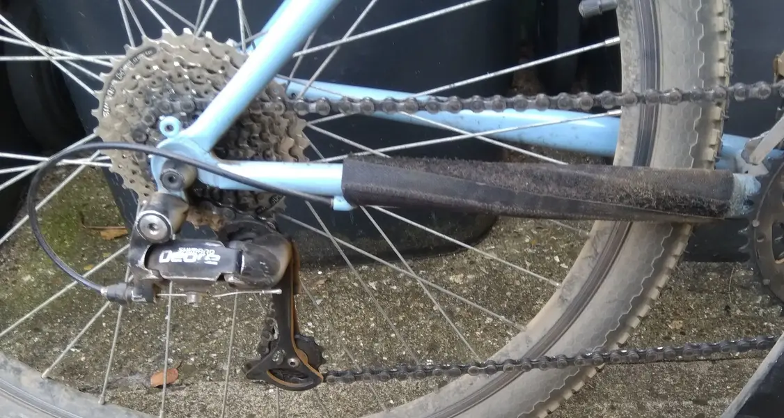

As far as I can make out, this happened: on a 3 x 8, I was cruising along in 3 and 6; I went over a few little bumps and the chain jumped from sprocket 6 to jammed between sprocket 8 and the dropout. Derailleur hanger is not bent; limit screws are fine; indexing is fine. As far as I can tell the chain just bounced and jammed the wheel. Fortunately, I wasn't going 30mph and I wasn't on a road. However, I don't want to repeat the experience. Anyone got any ideas why this happened? Rear mech set up as in the photo below:
I would say you need a new chain as yours looks tired to say the least , I had a similar thing happen on my old Dawes that I only use for the canal towpaths, it would jump gears suddenly esp under load . New chain and no problems at all now...worth a try.

The chain is only a couple of months old and has done less than 300 miles. However, I recently put an old cassette on to try some different ratios and the 6 to 7 changing has been a bit odd.
Chains do jump about, some people remove links to keep the chain tensioned more or fit a device like a DCD.
Yes. I've been wondering about this today and, on reflection and less dazed, I think that what must have happened is that the chain bounced (this is my springiest bike), got wedged between the cassette and dropout, which stopped the chain rings dead and my pedalling efforts and momentum sent me over. Either that or I've lost the ability to ride over bumps the size of moderately heaped dinner plates. :facepalm: The concern is that it could have happened somewhere where the consequences would have been much worse, e.g. right next to a five ft drop to a stony beach. I don't want my cycling to suffer the same fate as Martyn Ashton's.
Unfortunately, the only clutch mech I can find that would be compatible with my 90s Gripshift is by SunRace and unavailable anywhere. I've never had a DCD but I've been investigating and I gather that they did work pretty well: good call. I can feel a bit of shopping coming on.

In the real world, back in the day up until people though they were pointless and more importantly look stupid, there where spoke guards, it stop this chain between the spokes nonsense (P.S. check the spokes, there may be bends and large gauges on them now, but that why the wheel stops fast as it pulls it around.).
Clean it up, ignore clutch mechs, look at some less worn gear and maybe a stronger spring rear mech or less worn jokey wheels(something else to check...) etc.

Like Hamster, I don't think I'll ever be sure what happened. The chain was off at the drop out end of the cassette, not the spokes end of the cassette, though. Whether that was a cause or consequence of the crash, I don't know. However, I cannot think of another reason for going over the top of the bars. If I had been taking chances and crashed I would accept it; the disturbing thing was that this was safe riding and it still happened - fortunately, not in traffic or at the edge of a precipice. Whatever, that bike is getting a brand new rear mech of one type or another before I go out on it again.

Most people ensure their bike is safe to ride by buying new or taking it to a mechanic. That's not always a guarantee, but as Retrobikers we ride old bikes and they can have issues. Pretty much every "good condition" old bike I've ever bought has had safety critical issues - sometimes I've discovered these in the stand, or sometimes on the trail. When it's out riding it can cause a scary moment. Jumping gears or odd shifting are a sign that something is not quite right so really it's best to sort these issues as soon as you can.
These days when I buy an old bike I always err on the side of caution. That tends to mean a full strip and rebuild before any serious riding. Intermittent drivetrain faults can be a pig to diagnose but I generally find that starting again and checking everything solves it. I don't use old cassettes unless I know their history, and chainrings get binned at the first sign they are misbehaving.
Even with all this care things need a decent shakedown. If you're running a mix of modern and old components you can have weird issues too.
Anyway as I say, sorry about the off. You've reminded me that my Giant has a chain suck problem when changing down to the smallest front ring, which sometimes means the chain jams. I think it's probably because it ideally needs a longer cage mech, but perhaps something to do with worn chainrings. It can take a while to fully diagnose and shake down these sorts of problems.
Whatever the problem is this bike only gets used for relatively gentle stuff at the moment! I was thinking about taking it for a ride today, but perhaps I'll fit a different mech first... :roll:
