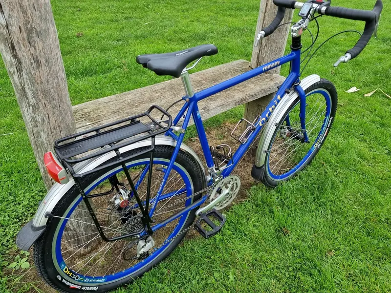

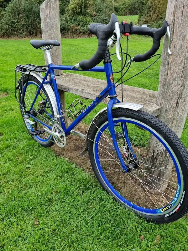

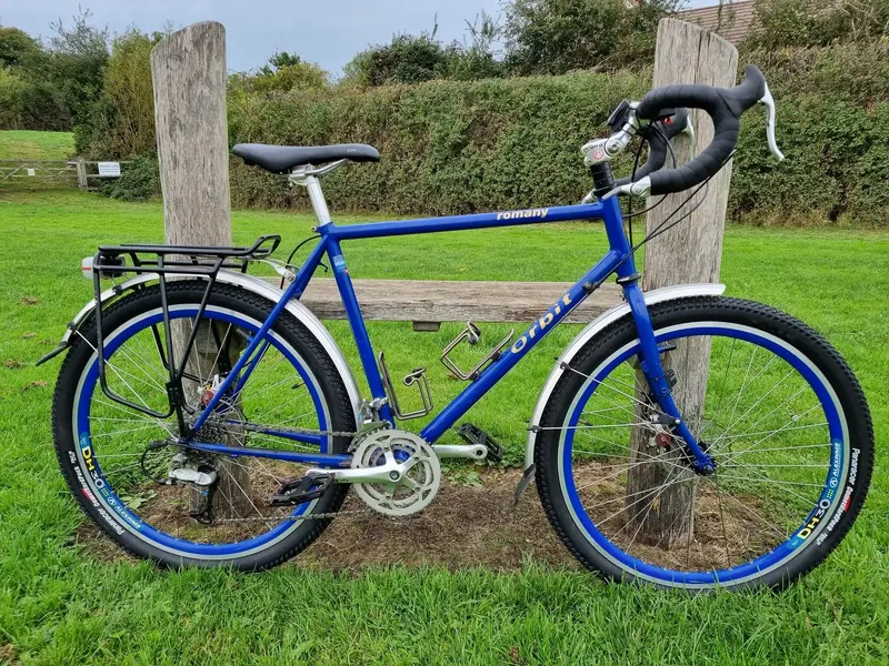

Firstly, the brake levers were fitted the wrong way round, I suspect they've been like this from new!
The Clarks disc brakes appear to be the MTB ones and have little or no pull. One of them was on it's way out anyway; so, I've swapped the calipers out for Avid BB5 R.
More fettling needed on the handlebar set up before the new bar tape is added.
Swapped the tyres out for new Panaracer 26 x 2.1. Admittedly, not as much puncture protection as the Schwalbes so I'll see how I get on with them.
At last, it's done.
Why do drop handlebars always look oversized in photos? Despite how it appears, they're not!
Very comfortable and planted. It's built to ride at my pace i.e. slow.
Rolls pretty well. I'll see how the tyres cope as I've never used this particular one before.
I took the front rack off as I'll probably use the bar bag.
Tried this saddle and initial thoughts are very good. If it doesn't work out then I'll swap it out for my Brooks Flyer.
