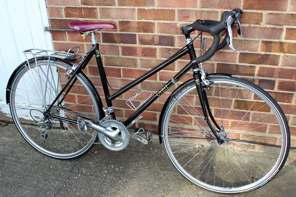

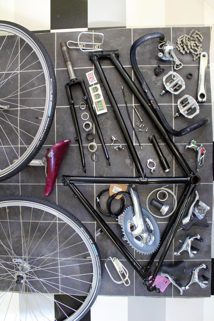

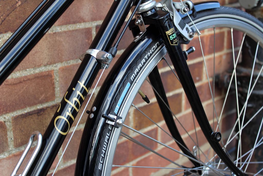

Had one of my friends' bikes in for a rebuild. It's an early 1990's Orbit step-through frame in 531c tubing which we found a while ago on eBay for not a lot of cash, but she's decided to take it touring around Scotland this summer so it needed some better gearing. I stripped it down and while it was away being re-painted amassed all the parts required to upgrade it to a Shimano Tiagra 10x3 groupset and threadless stem conversion and also renew pretty much everything at the same time.
Here's what I started off with this morning:

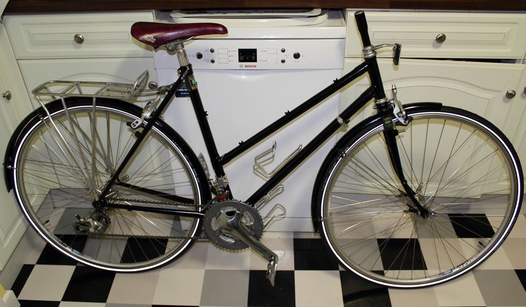

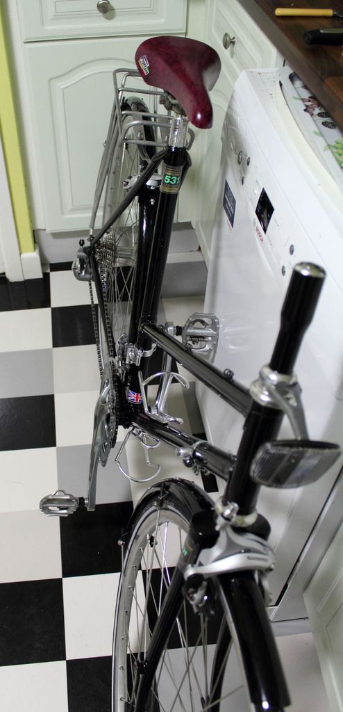

Annoyingly the new stem hasn't arrived yet (it was a bit of a pain to find an 80 mm one that would clamp the 26mm bars for a decent price) so it's only about 2/3 built but I'm happy with it so far.
Should be done by early next week!
