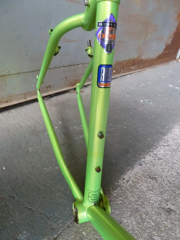

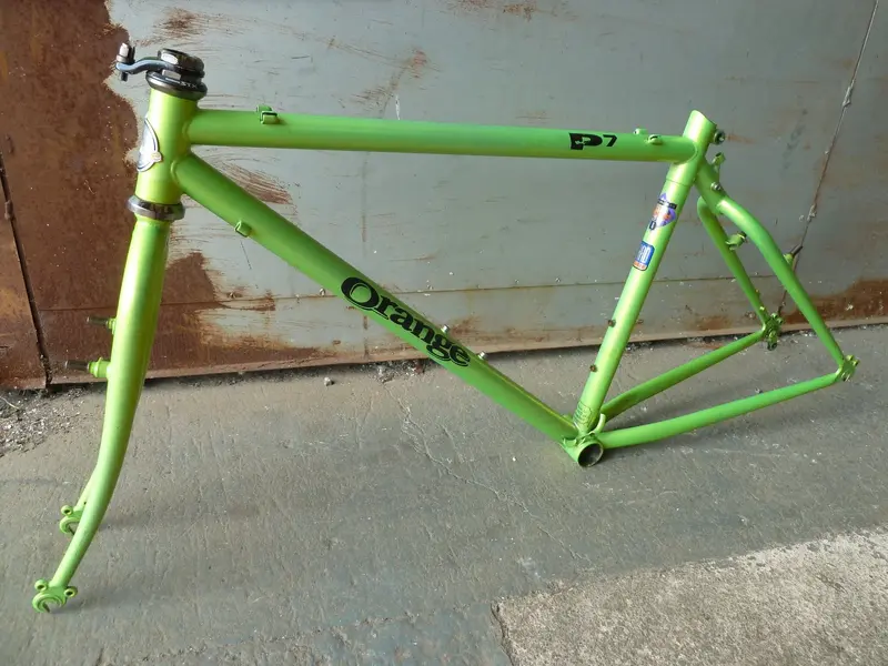

any orange fans or knowledge heads got any year and info on this lovely old green p7

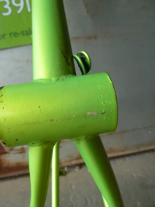

frame number on bb is A2033701
muchos thankos

March 92 from frame number. Rear facing seatpost slot also dates as (I think) pre 96
Slime Green seems a strange colour for such an early frame
Not sure the decals are right either, so might be a respray - possibly factory.
thanks for that great info
yeh i thought it was early 90s - def seems like legit orange factory paint job and not diy resprayed, u can tell by eye and the paint bevel and cover is exactly the same as other oranges i ve seen in the flesh
yeh p7 decals seems to have been slightly damaged or rubbed out of position
also slight paint fade/rubbing from age/use on top tube aswell

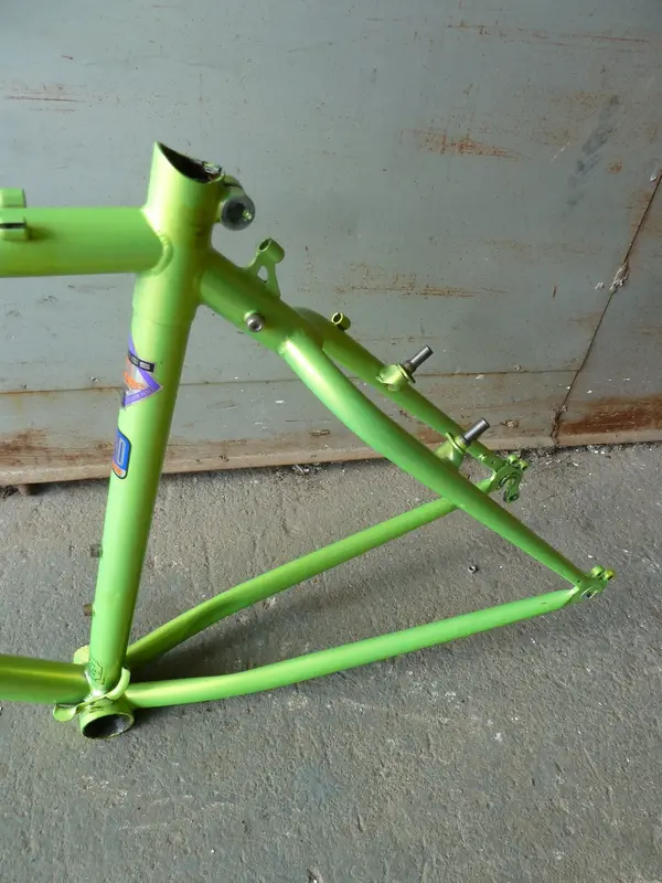

1992 pre-dates the P7 so might be a Prestige maybe?
It's got the triangular hole in the rear canti stop which I think only Prestiges had.
Might have gone back for a respray after Orange had ran out of Prestige decals.
It does look in great nick - as I said, probably a factory respray - but also looks quite small. Colour may be offputting for someone looking for originality. Orange may have history on the frame number if you give them a call, they are pretty friendly.
I think the upper end of £50-£75 is what I'd offer (if I was buying) as its a great steel frame - and looks very much like a prestige.
The canti stop like that was also on P7 in 1994-96. However, they didn't have the double thickness at the top of the seat tube. It looks resprayed and re-stickered, the frame number tells all.

are you 99% sure on age from frame number as orange couldnt help
and how did u know just mainly for reference for in future as well
is it certain numbers and combos
It's almost certainly a Prestige, which in itself dates it. In terms of the frame number Look at the first 4 characters
A2033701
A - made by APro
2 - the year (90's) ie 9X
03 - the month
