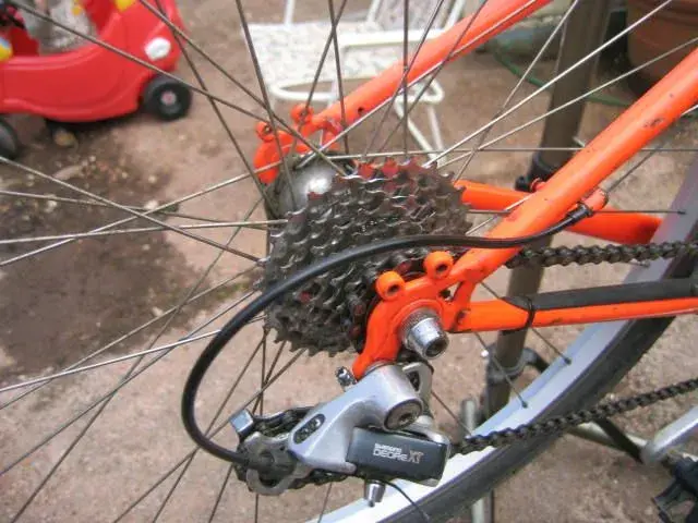

Have you got a pic of the rear triangle? - that should confirm it. The earlier up to '91 frames had thicker stays and very poor mud clearance, also under BB routing. The new '92 model had much thinner 'pencil' seat stays and a brazed on pressed steel loop on top of the BB. IIRC the down tube profile also changed to become wider (they just squashed it!) at the BB junction. Besides this I seem to remember the old style orange/white fade was stopped in '92.

Hi guys,
The front mech cable routing is over the BB (See pic), and it does have a 'ovalised' bottom end of the seattube.
its a 1" headset as well.

http://i30.photobucket.com/albums/c320/retrobikeguy/121_2107.jpg
Rear triangle ➡️
grateful for all your help chaps.
Yes, looks like a '92 (those decals are post '92 too). Different drop outs on earlier models too and note fatter stays - see pic below. When I ordered mine in late 1991/early '92, I ordered a pink and white. When delivery came they were satin black - this was the first batch of the new design frame. Seems they did do orange/white after all.
Nice bike - keep it orange/white - it is the classic colour for old Oranges IMHO.
