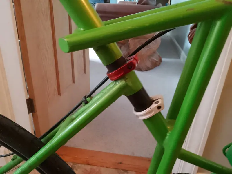

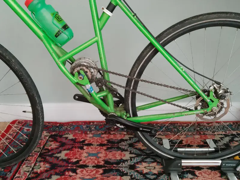

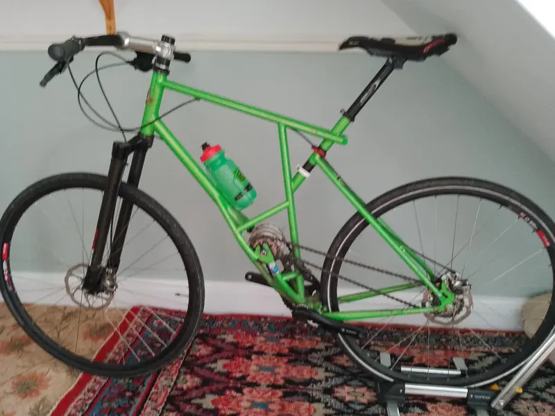

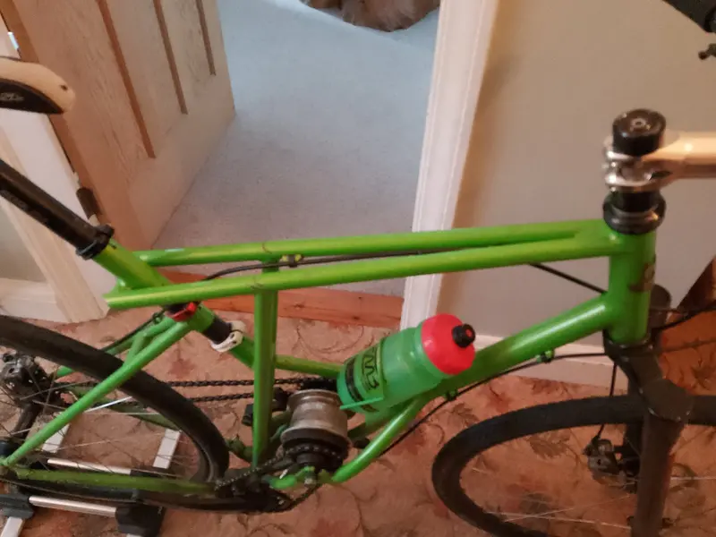

Built as a touring bike with a remote Shimano 8 speed hub frame mounted and detachable backend with the idea that the bike could be broken down and fitted into a custom made suitcase that would double as a bike trailer. This was a prototype build.

The remote gear hub seems like unnecessary complexity to me, but it is definitely interesting. Can anyone provide insight into why they may have chosen this path as opposed to simply putting the hub in a wheel?
The reasoning was so you could take the back end (which is attached by the chainstay next to the bottom bracket and also secured by the seatpost) off without the complexity of reattaching the gear cable however you still have to detach the cable back disc. As stated before it was a prototype to see what could be done.
Apparently it rides really smooth but not from personal use as it is too big for me.
