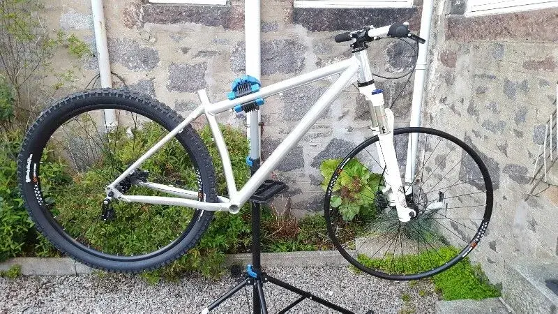

After selling my Inbred 29'er Singlespeed last year I found that actually I really missed it, it was the bike that I could just grab from the shed and go for a quick ride, a long ride, or an all day ride, all with minimal fuss and maintenance.
And Santa Klaus :xmas-wink: replied to my wanted ad for a 29'er frame with this On-One Scandal frame and Rockshox Reba forks.
The deal was done and I'm now in the process of putting it together.
The plan was to build a simple and relatively inexpensive singlespeed 29'er, and as we know things don't always go to plan! :lol:
Much of the finishing kit is from On-One, including their Fleegle bars that are a bargain at £5. I found some used On-One 29"wheels with tyres and a singlespeed kit already fitted on another bike forum. So far so good.... then I decided I'd need a dropper seatpost so again bought one from a mtb forum, followed by XT brakes (because they were local and a good price) and XT cranks (another good price)... so the budget has been well and truly blown :facepalm: oh well... at least I don't need to buy mechs, shifters and cassette :lol:
Got things rolling today, hopefully have it rideable by next weekend...

These lighter evenings are great! :D got a bit more done today.
Still waiting on a bottom bracket turning up in the post so the cranks have something to stop them falling out the frame.
Hoses will probably need shortened and tidied up, but I'll leave that until after I've ridden the finished bike a few times as I may decide to go with some bars with more rise to them, looking at the Fleegle's they are swept back but there's no rise to them .... time will tell...

It's the "Raw" finish, which I think is actually anodised?
Realised I'll have to get some new olives/barbs to shorten the hoses.
Currently it has 34:16 gearing which is way too difficult to pedal on my normal trails.
So I'm changing it to 30:20-ish which is what I used on my previous Inbred 29'er SS.
Did a bit more fettling after work today. Fitted a 30T narrow-wide chainring (gives me the option to run 1x gearing at any point if I feel like it), and chucked on a 21T sprocket from a cassette, just a temporary measure till I settle on what size sprocket works best for where I ride.
Just need to bleed the rear brake before riding as the chap I bought the brakes from had disconnected the hose to remove them from his bike.
Weighed in at 28lbs, I'm sure the tyres alone are a fair few lbs! They look like Fat bike tyres from above :lol:
