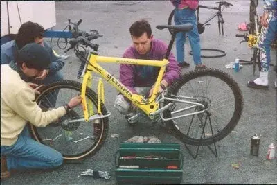

They started business again in the oncoming "gravity" bikes (verry early '90)
This bike has a travel of around 100 mm front and back
Alberto Ancillotti is the man that on the left is setting the front suspension (prototype)
