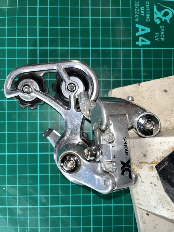

I've only seen this one (Suntour LePree) and it was on a Nishiki Belair I bought recently...

What was the point of three pullys?

Thats it!
The Loch Ness Monster of derailleurs.

ricohman
On touring bikes it took up a great deal of chain.
These bikes would run a 32 or 34 rear with a 26 to 28 front.

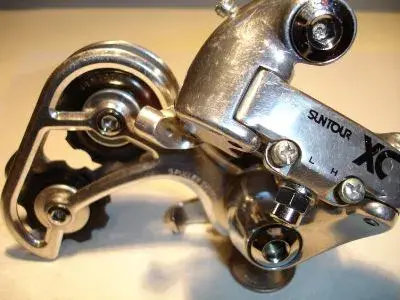

SunTour put out a couple of different derailleurs with the 3-pully configuration. There are photos of a few of them over on Velobase.com. LePree was certainly one, I think there was a Cyclone as well? I'll leave it up to the curious to go look.
LWaB
AFAIR Nishiki came up with the design and licenced Suntour to build it. Virtually every one I've ever seen was on a Nishiki-built bike.

Very cool to see one of these 3 pully setups in use in the photo above. From just the photos on velobase it was hard to get an idea of how it was supposed to work.

What the heck was that supposed to do which a standard long cage derailleur could not?
A simple Shimano long cage Deore from the era could already efficiently wrap plenty of chain. So was this intended just to keep the lower pulley higher off the ground? ... or, was it to work around the lack of a spring loaded upper pivit bolt which most any other manufacturer was using by this time? It seems the triple pulley models were only used for a few years during the mid 1980s. Was it a bad concept? Or, maybe just too heavy and extra costly with the added pulley?
I'd really love to know why the design was considered worthwhile since the 1976 Cyclone seemed to work just great, and by 1985 the long cage Suntour XC was a sturdy, fine working and very modern looking model.
LWaB
It wrapped more chain than any standard long cage mech (no chain sag in small/small combinations) and it kept the chain a little higher (and probably cleaner). The major reason is the perennial one (I expect), it looked different.
