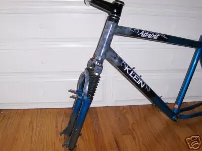

Night Storm Adroit
Not an official paintjob and the bike is with Attitude downtube even though it has X in the serial. Not worth of big money people seem to already offer for it. I guess the bidders do think that's it's an original Klein paintjob...
The 1996 Klein Adroits have the same frames as the Attitudes. Only difference is the X in the framenumber so it is a original Adroit
as far as possible.
People look only at the Nightstorm paintjob wich look ok but....
Bought my own new Attitude from him two weeks ago he's a good seller, my frame looked stunning new!!!
Seller must be fine I think....
Martin":s1mgks58 said:
The 1996 Klein Adroits have the same frames as the Attitudes. Only difference is the X in the framenumber so it is a original Adroit as far as possible.
True and not.
Most '96 Adroits had the same frame as Attitudes. Some even had T in the serial nbr like Attitudes. However, the some of the 1996 Adroits were the real ones with 2" downtubes. For example the one that ended on German eBay yesterday was like that. The first batch had frame-coloured MC2s too but later they were changed to black ones to cut costs.
