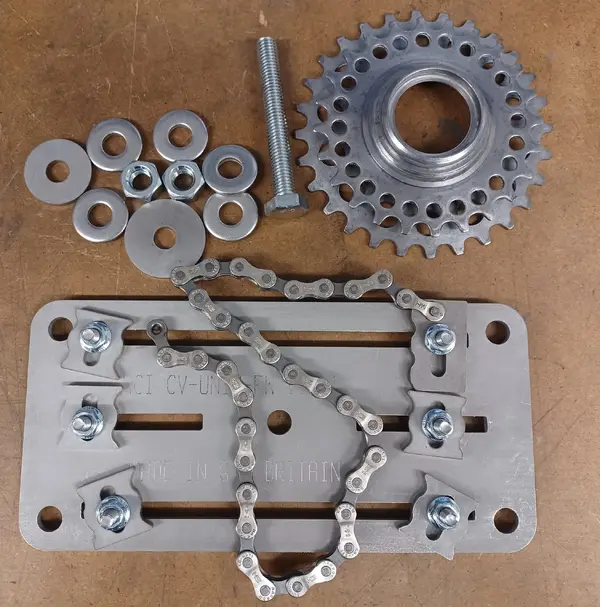

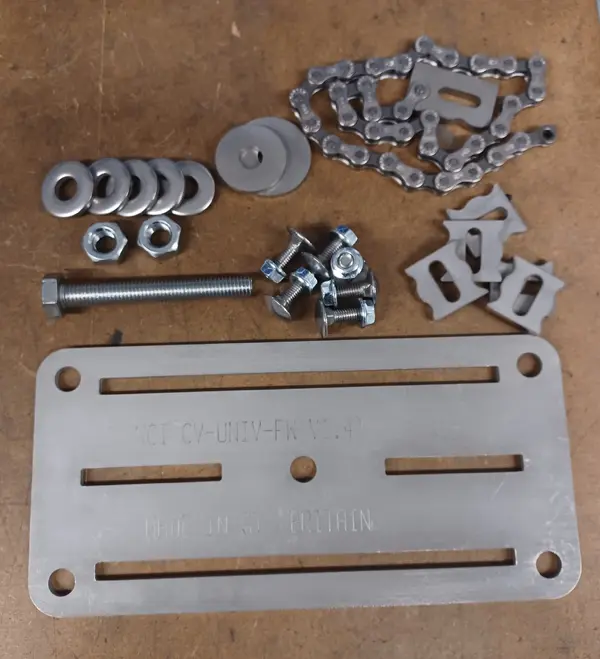

Picked this freewheel vice up for under £20 which I thought was pretty reasonable. It also works!
It can be bolted direct to a workbench, but I think I'll fix it to a block of metal / wood so I can hold it in a vice.

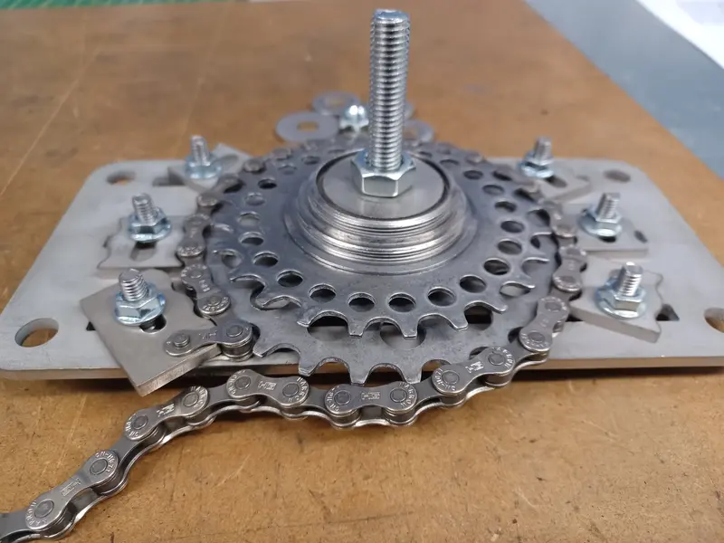

I would suspect you may have the bolts the wrong way, and are protruding upwards too much which would foul the chain whip throw / access.
You can re-purpose a bench vice by removing the jaws. screwing in some angle iron with four very flat head coach bolts to grip the largest sprocket and hold it flat. The old dirty trick is some waste chain around the largest sprocket and the two loose ends of the chain just jammed and taught in a bench vice.

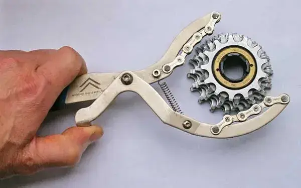

There is also the BTL-122 from BBB tools that seems proven in the real world and can provide some inspiration for a homemade gizmo.
I think they are intended to be that way up since the square head of the coach bolt fits exactly into the slot on the underside of the plate. You also get some fat washers to hold the plate just proud of the surface you are bolting it to, to accommodate the coach bolt heads. However, that said, you are exactly correct... they do get in the way a little bit for removing that last sprocket. For the smaller sprockets, a Unior 1670/2BI is recommend, but a chain whip doesn't really get in the way.
