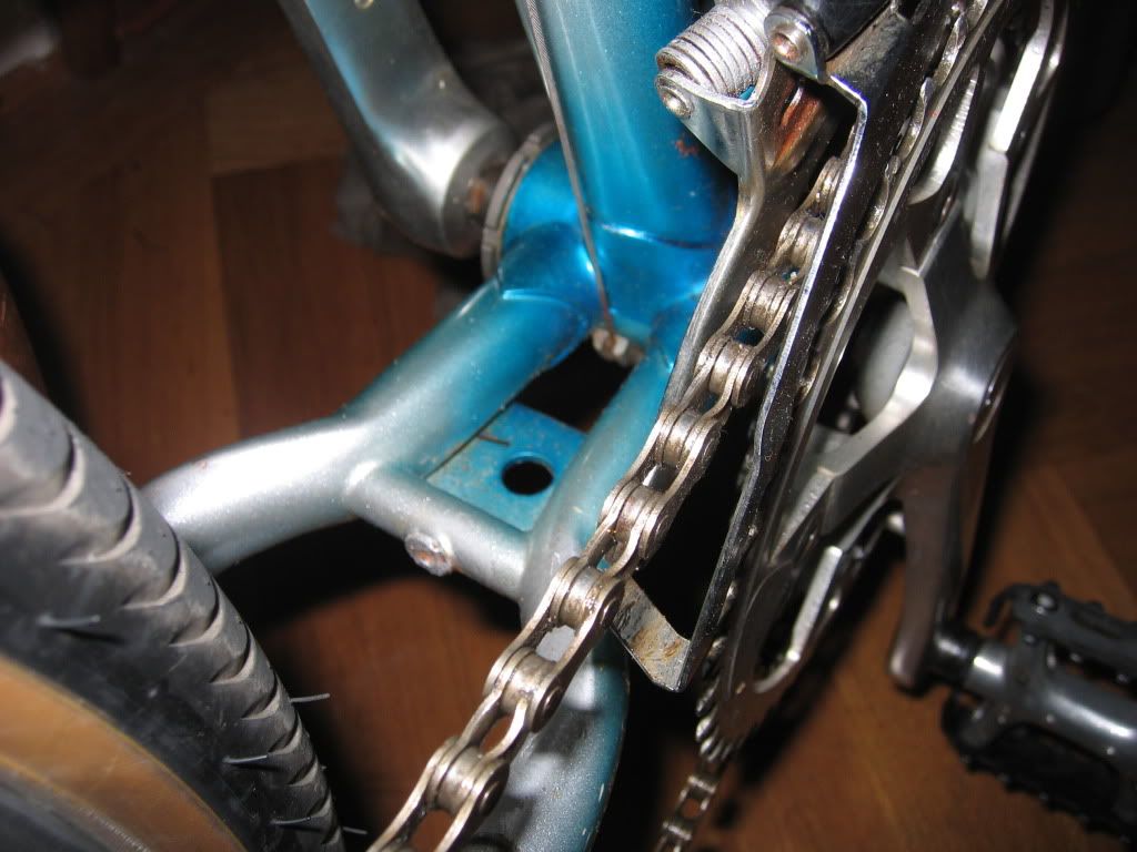

has also a distinctive chainstay design
very distinctive cable stops too, with top tube brake cable in the top tube " a la klein"

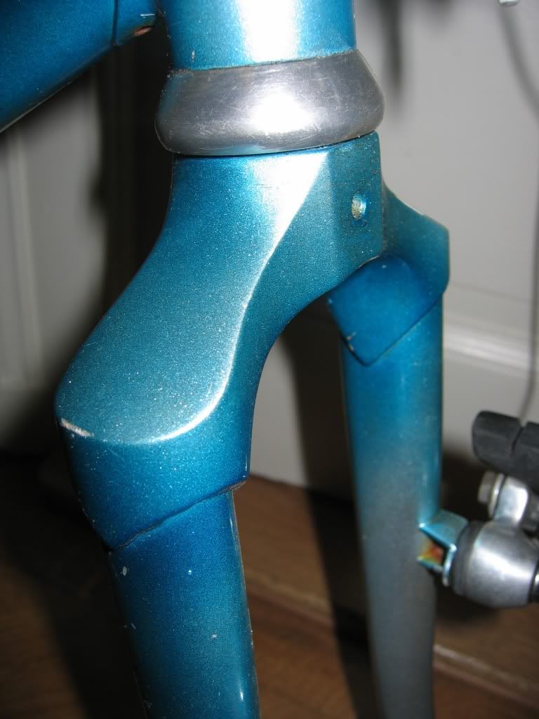

was known for this fork made with cinelli top piece ( he apparently bought all the stock from them when they decided to stop doing it)

and cinelli microfusion crown on which he brazed his legs for greater comfort than unicrown forks
