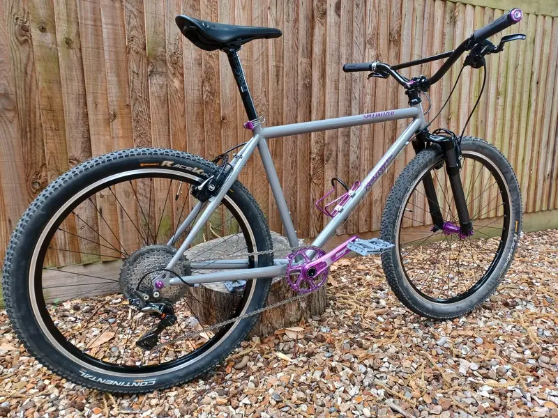

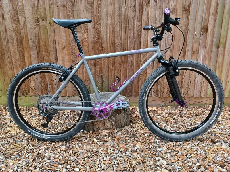

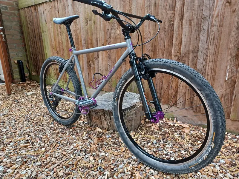

I know there isn't a lot of "retro" left on the bike, but there is now even less after the South Downs Way, a very poorly cut steerer tube (previous owner) and a dearth of 1" JIS headsets with zero stack height conspired to wreck my headset / front fork a couple of weekends ago. New forks installed this afternoon...

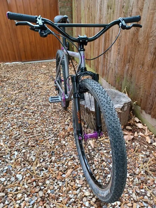

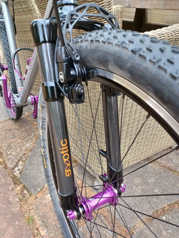

Hi mate, it is the unidirectional carbon model (LINK)
- 1" steerer
- 26" wheels
- 390mm from crown to dropouts
- 42mm rake
They also do a 425mm and a 445mm length one. Same 42mm rake for all three.

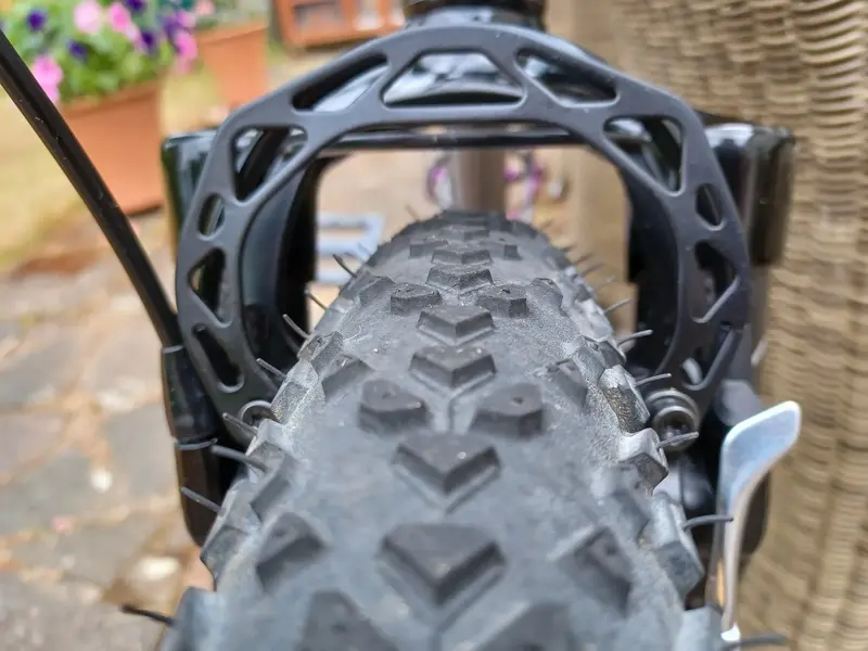

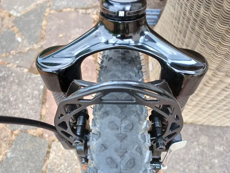

It matched the geometry of the original fork almost exactly. Haven't really given it a workout, but braking is absolutely fine. I've got those Magura HS33 on it which could stop a tank without any judder, they've got perfect modulation.

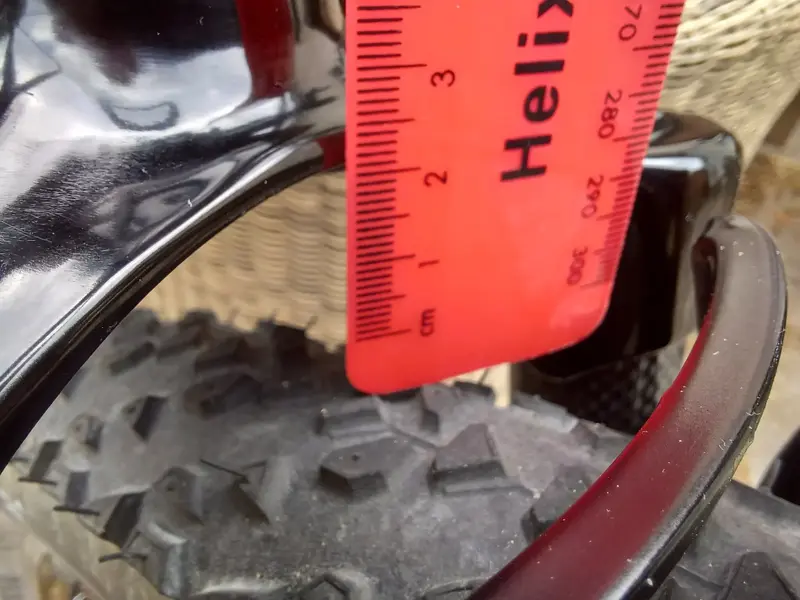

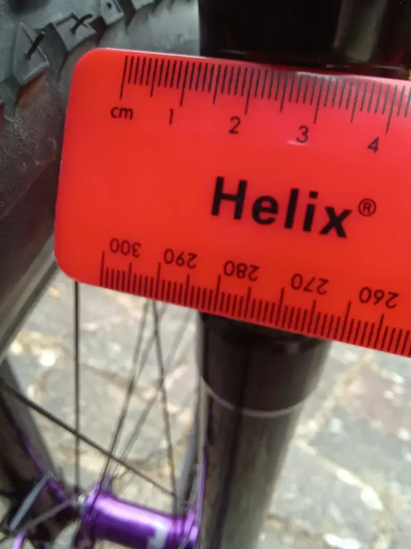

I've got a 2.2" tire fitted and there's still plenty of room. How big were you looking to go?
Few more pics attached if it helps...
I am gonna throw a 2.4 tire up front and get the 425mm ac fork. I suspect V brakes won´t even clear my tire; fine: i will go w/ cantis.
