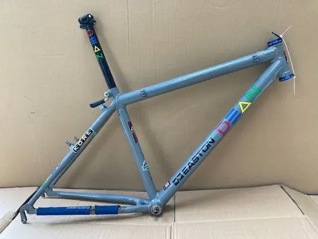

Need help identifying frame DEAN/HEAD
Nice frames!
The DEAN is probably aluminum, given the size of the tubes and the fact that it is pained; could also be carbore.
Easton has only produced aluminum tubes AFAIK, but wasn't involved in the Carbore, nor done any titan/titanium.
If the sticker at the DEAN is correct that's than already a clear hint.

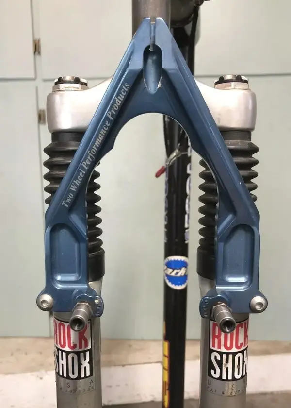

The fork is maybe even more interesting as the Frame.
It has for instance an TWP arch
If the sticker is correct it had a tuning coil springs from Speed.
Easton does carbon as well, though with the frame gussets and size of tubing as already mentioned I would say it is Aluminium.
