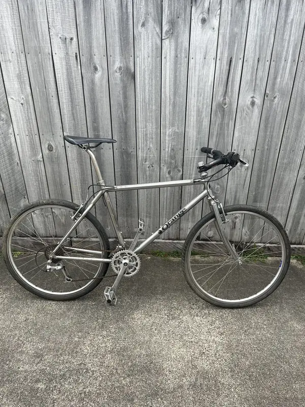

Need help getting an ID and date on this Orange Bikes frame please
Jamesgornell
Just picked this thing up for £40 I’m planning on bringing it back to it’s former glory but need help ID’ing it so I can start sourcing the right parts.
Do any of the Orange wizards out there have any idea what I have on my hands here?

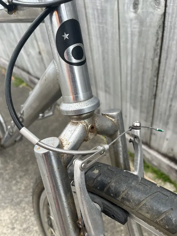

Full STX RC besides the brakes they are some kind of shimano V brakes.

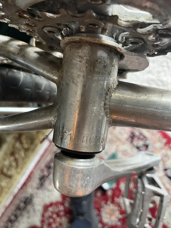

Its a score even if the bb shell turns out that is a crack... looks like a p7 that will clean up.. but as a parts donor its a major score!

I reckon that’s a dog hair on the bb shell.

It's a 1997 model by the way.
