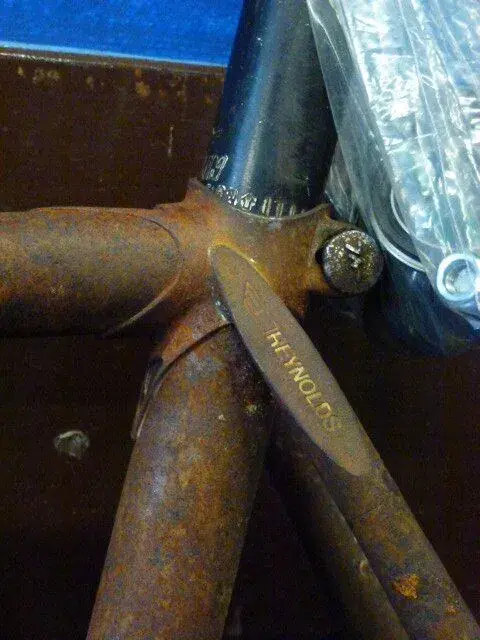

28mm seat tube and RGF shell are Metric, so it is the earlier version of 753; that is 1983 or before, so if it has a 753R decal (Imperial 753 from post 1983 with a 28.6 seat tube) that probably means a later renovation.

Came across a couple BITD. Interested to see pics of the frame :) If it has no decals have you weighed it to work out what it's made of.

Have a few photo's that may help with ID.
Seat stays, silver solder can clearly be seen around the lug. note the Reynolds panto.
