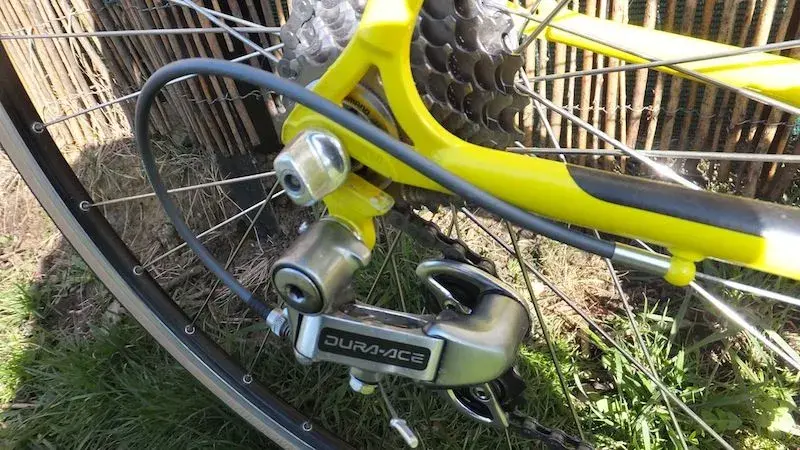

Thought I'd share my finished build on a Pinarello Veneto frame. I'm not entirely sure how old the frame is, I bought it off eBay as New Old Stock and was claimed as mid-eighties. I just liked the yellow. After that I decided I would stick completely to Shimano Dura-ace components. I wasn't looking for any sort of period re-build, just a great-looking bike I could take out on the roads this summer. This was my first build of any sort, and apart from jamming a ferrule in the top tube, and hence having to re-route cables along top, I think it's okay. It rides beautifully, and the gear changing is honey smooth and whisper quiet.
The brake levers are the only non-dura-ace part, simply couldn't find any on eBay. All the components were sourced individually off eBay and are all in the 7400 series.
Cinelli 1R stem and some vintage Phillips handlebars (which were the only thing I already had before building). Got some lovely Cinelli handlebars but couldn't get brake lever clamps around the bends.
The wheels are Mavic Open Pro on Dura-Ace hubs.

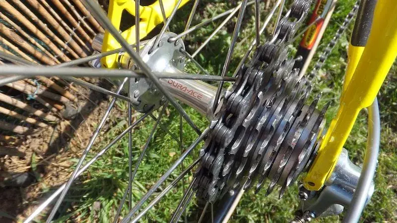

Took this for a spin around Richmond Park on Sunday, and the only thing I realised is that I might need a smaller inner chain-ring. The real cassette is 8-speed and doesn't have a huge range, so hills are a bit of leg killer.

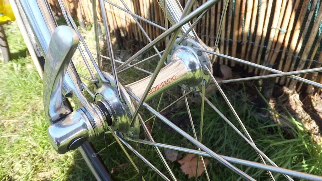

Turn the front skewer so its on the left side of the hub.

Ian Raleigh":33l7duz3 said:
Very nice but the bar tape should go under the brake hoods and not over them!
Why?
Why?
If the bar tape is under the hoods the bars it will look far neater, if bar tape is exposed it will wear on the edges and will look a mess.
All skewers go on the left, Its been that was since the dawn of the quick release, though some older rear Campag' ones was fitted to the right.
Funny - never noticed before about bar tape over hoods, will remember next time. Will leave my skewer on the right though, just to be obstinate and see how many people point it out to me.

Lovely bike apart from the q/r the wrong way around :lol: :lol: :lol:

Oh I know they're not hills, just meant that the 52/42 with a close spaced cassette didn't give me many options for spinning, and I realised that it might be a problem when I get on some hills proper. Currently trying to see if can find a 39t small ring which will work on a 7400 dura-ace.

39 would be good , I use a 53/39 split on one bike , and a 54/39 on the latest british steel project I've nearly finished .
