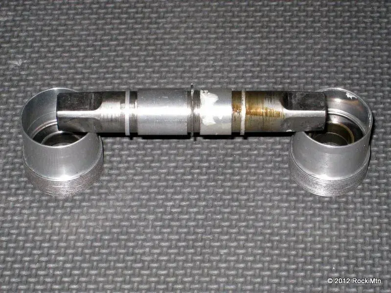

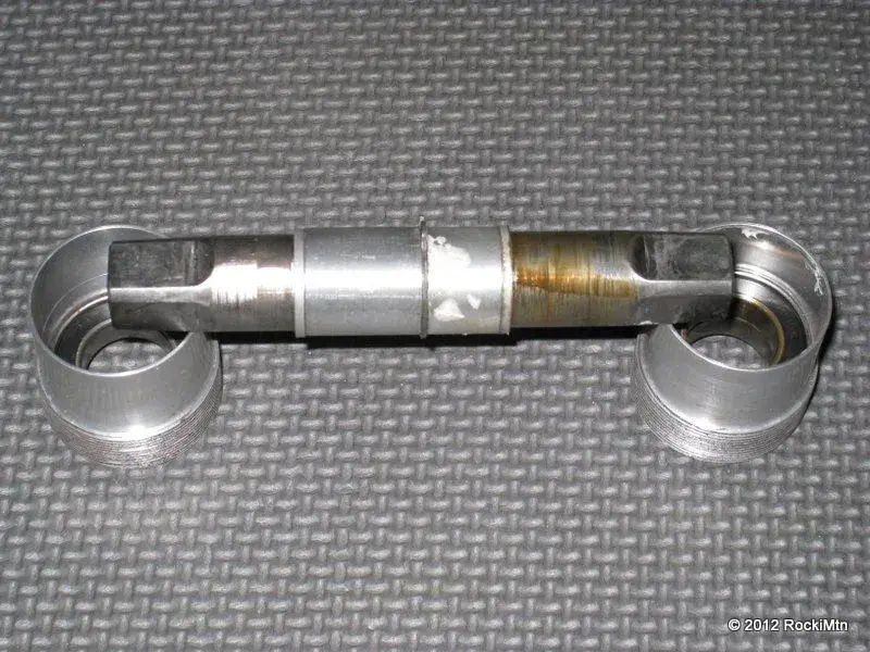

here's what i got. left cup has one bearing cartridge, right side has two.
thin sleeve spacer, long sleeve spacer, c-clip secured groove in the centre of axle, medium sleeve spacer, and thin sleeve spacer. when put together, cups make contact and there's little to no left/right play in axle.

I would check that the circlip is still strong and sitting within the groove. Once that dies then the axle will be able to move at will no matter how many spacers or bearings you have. It's probably the only explanation if the BB has previously been fine.
Thanks for the info guys, the circlip on mine seems fine but the spacers in mine are the same length both sides which is probably why its moving. I've just given it a lube and clean which is why the side to side movement is possibly more apparent. Gt Steve has sent me a spacer that may have come from my bb or maybe a litespeed one. I'll fit it tomorrow and see what happens.
