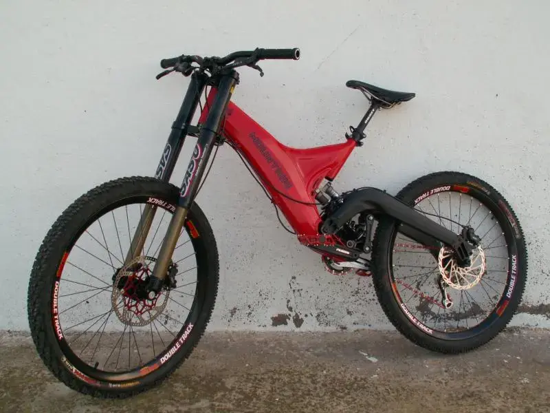

Here's my Mountain Cycle shockwave 9.5 as it was built up initially in 2009.
Initially I was just trying to build up something relatively cheaply (for like < €2k at the time) to ride in Tenerife while I was living there.
Couldn't really afford or justify spending any more than that as DH was something totally new to me.
Frame
I initially got the frame new on ebay for like €640. Which I thought was pretty cheap, considering that it was brand new.
It's a size large. Glad it is a large and not medium as the reach is pretty short.

Anyway, here is how it looked back in 2009:

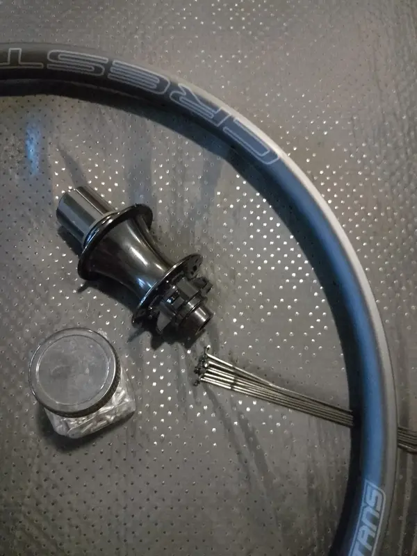

I decided to build another wheelset for this bike.
I built the original one myself, but it's really overkill (read:heavy).

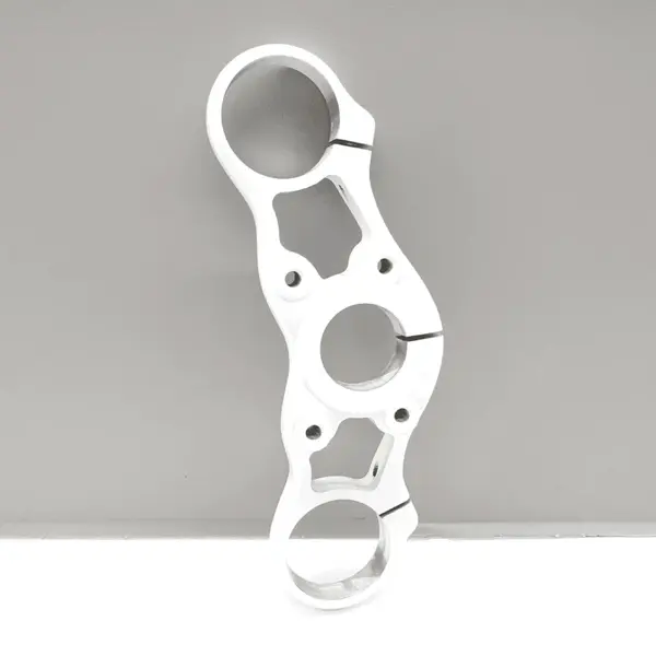

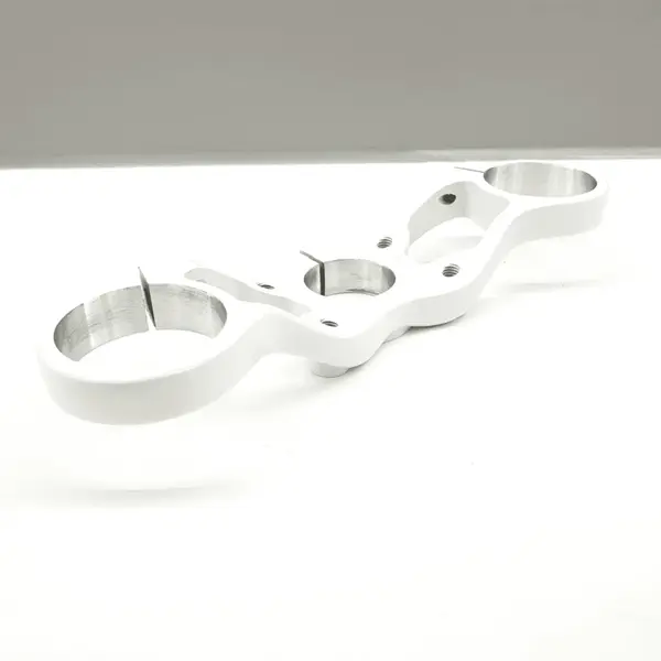

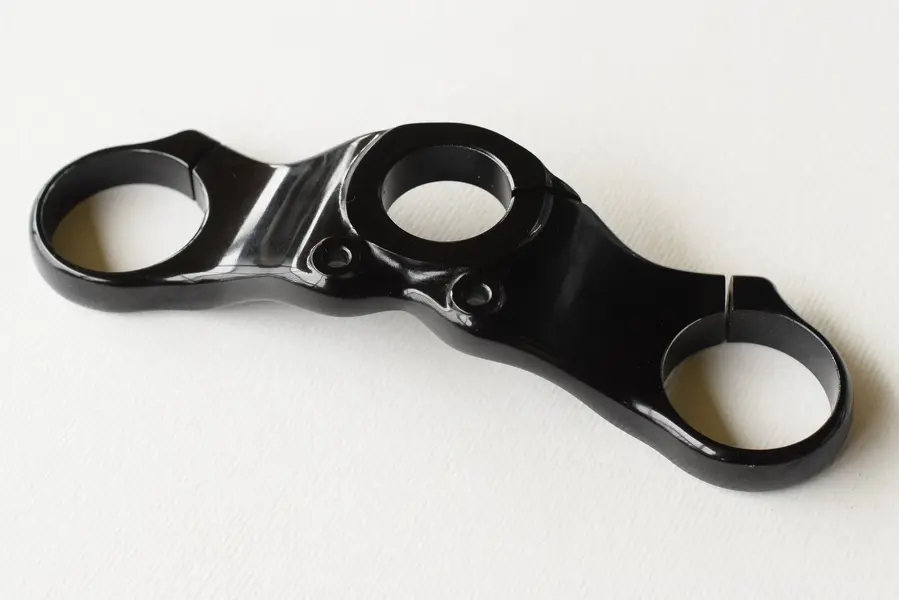

I ended up getting a 2010 model fork but it had an older style two-bolt Marzocchi crown.
Those older marzocchi direct mount stems are ridiculously expensive.😲
So after digging around online for a while I realised I could simply buy a new crown instead. It fits!
But the problem was that the only new direct mount crown I could find was white.
I bought it anyway. Here it is stripped and sanded back. There are still a couple of areas to sand.
I'm thinking of taking this to the anodisers to get glossy anodised as I'm probably no good with spray paint.
The old crown is for sale here (pictured last, for comparison).

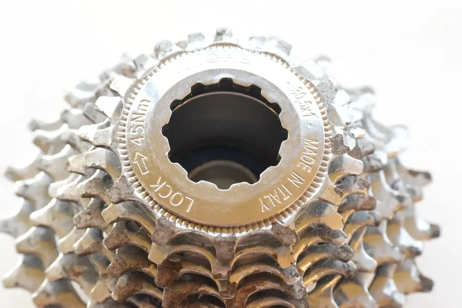

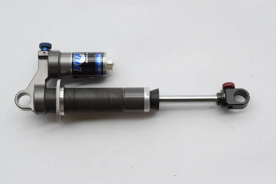

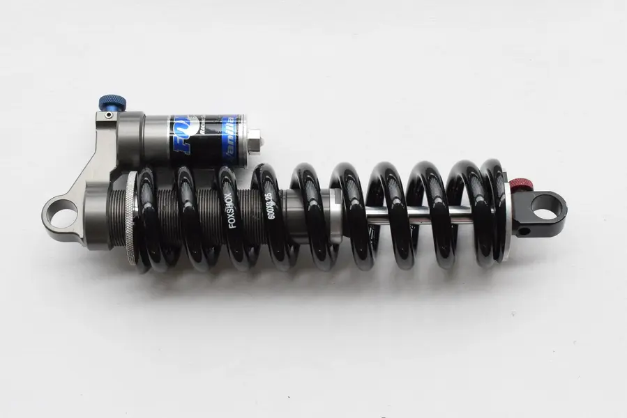

The old shock, cassette and RD as shown.
The shock came with the bike and had a 400lb spring.
I didn't really know it at the time, but this was pretty much the ideal spring rate for my weight back then.
Now I have unfortunately put on a few kg, need a slightly heavier spring. I tried the recommended 500lb and even 600lb ones but I felt they were much too stiff for my style of riding. So I am going to 450lb. I also have a 400lb ready as I'm hoping to lose some weight.
The old cassette was a 12-23T 9 speed miche unit for road bikes.
It was just something I had lying around at the time I believe.

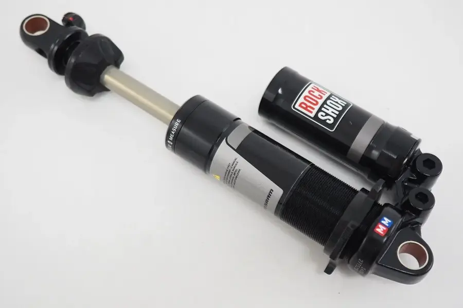

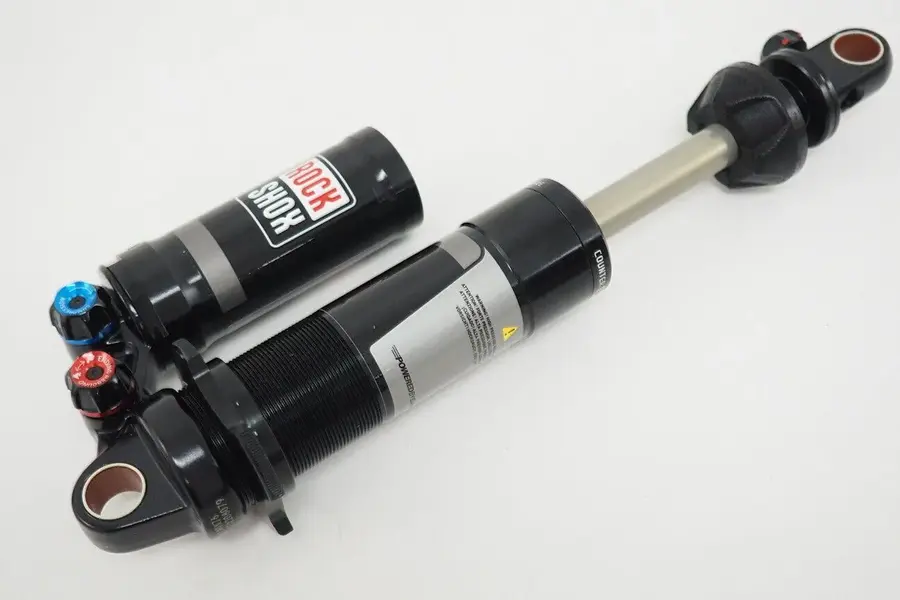

In the mean time, I got a new Monarch RT shock for one of my other bikes and I was super impressed with how it performs.
I experimented with a shorter shock (Marzocchi bomber CR 8.75x2.75") but I thought it lowered the rear end too much.
So that may be up for sale soon, depends.
By this time I had already decided to sell the old Fox shock.
So in the end I decided to get a new shock. Except I hate paying the retail price for suspension.
I sold the shock (without the spring) to someone in Peru, Cuzco for AU$200 + shipping.

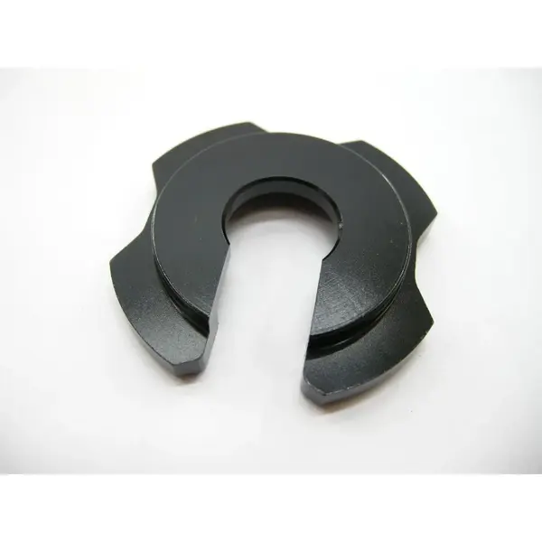

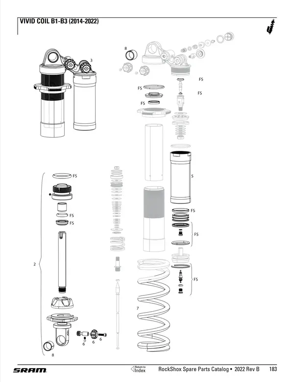

Another seller accepted my offer of US$140 for a NIB rockshox vivid R2C but missing the spring retainer.
I used planet express to forward that to Australia.

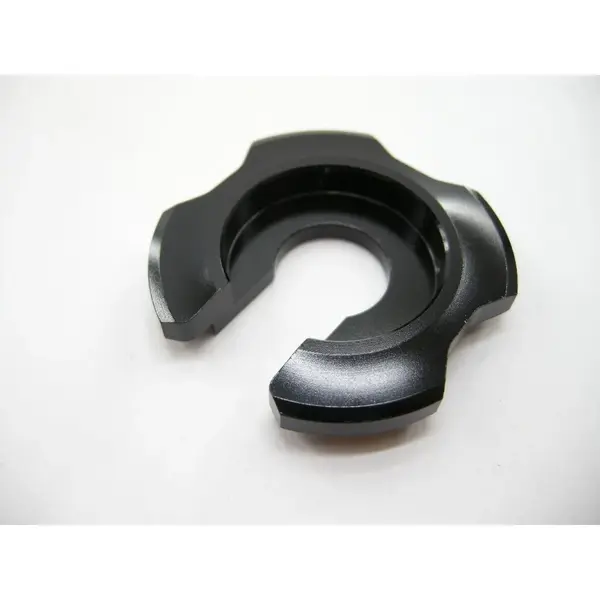

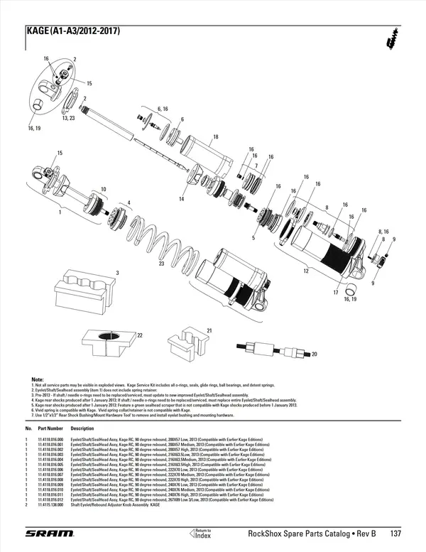

Managed to source a new spring retainer from Switzerland, this place for only CHF13.55 (that's £12).
[CHF19.50 with shipping, cbf'd converting that]. This is literally the last place in the world you can get these, I swear.
They used to sell these separately (in 2017). Not anymore!
So now if you look up the 2022 spare parts catalogue, you won't find this spring collar listed separately anymore.
Rockshox now sells the entire sub-assembly, as pictured, complete with piston shaft, eyelet etc, and obviously it costs a lot more.
Part number 11.4115.149.000.
It's from a Kage shock. It looks the same. Good lord I hope it fits or I'll look stupid!
Total price of new shock, shipped = AU$323. Retail price here if and when it's available? AU$849! It can be had online for around AU$700. But still.
This is a slightly older model however.

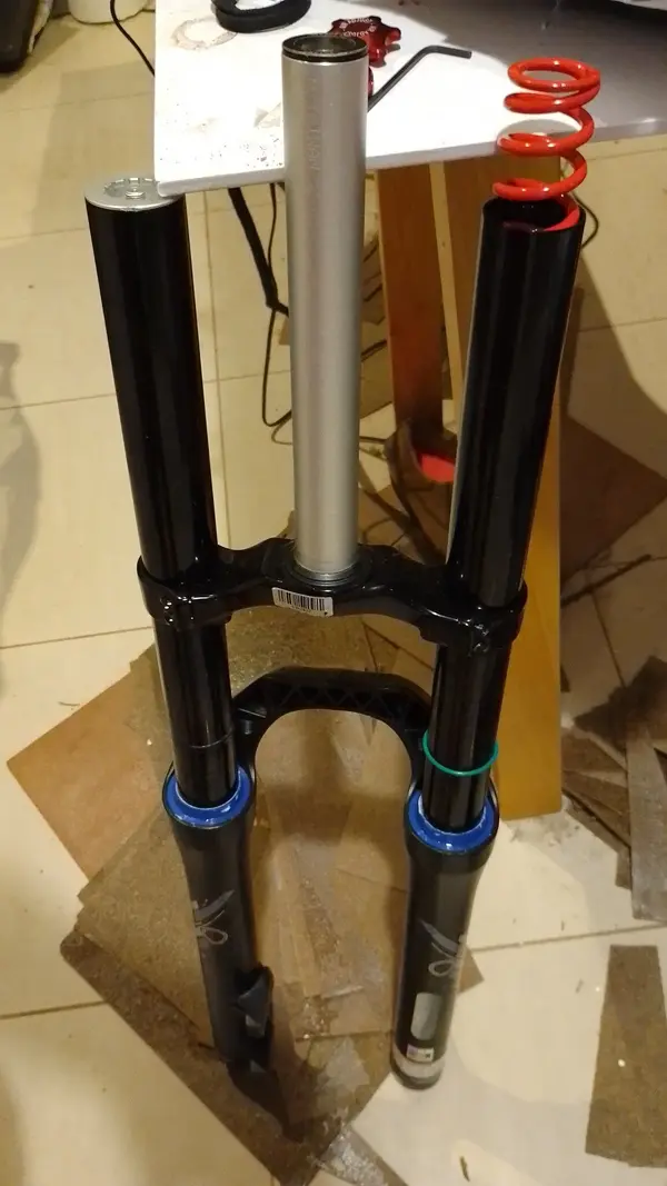

Now on to the fork. This is a not so old Marzocchi 888 RCV klunker that I bought new while I was in Tenerife around the year 2010.
It was basically the best fork that I could afford at the time, with adjustable rebound and compression damping (although it seems the compression knob doesn't do that much).
Anyway. I am/was still not keen on forking out for a new fork, because the price of downhill forks has gone up considerably since then. I'm just not going to pay 2 grand for a new fork considering how much (or how little) use it's going to get (and considering my skill level). Also, they're not even available for 26" wheel size anymore I don't think. Besides, these particular forks haven't seen much use. So it's these or nothing.
Even so, after getting a new RockShox Monarch RL rear shock on another bike, and then a Reba SL fork to go with that, I realised that these downhill forks were not as plush as maybe they could be. Because it doesn't make sense that a 120mm fork is plusher than a 200mm fork.
Deciding I'd deal with the spring rate later, I opened them up and moved from a stock 7.5wt oil (in both legs) to a lighter weight 5wt oil in the rebound leg and 10wt oil in the compression leg. Changed the seals, put fluorinated PFPAE grease in there. Still, pressing down on them (in the living room🤪) something did not quite feel right. I think the spring rate was too firm for my riding style.
It seems Marzocchi 888 springs are kind of not that easy to get a hold of.😬
And they are notoriously expensive for what they are if/when you can get them.
I did a bunch of googling online (which is not always a good thing, because you can make a lot of mistakes that way).

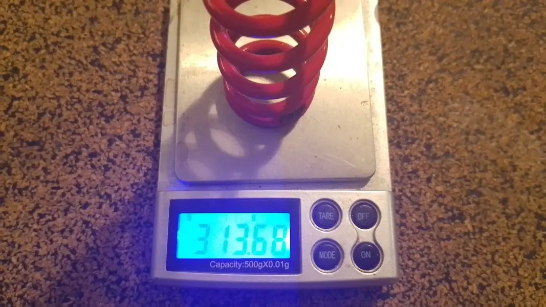

And it turns out that the Fox 40 spring is basically the exact same length and outer diameter as the Marzocchi 888 spring.
And there's a guide online somewhere where some dude uses a wine cork to bodge it so that it fits properly.
I got this great deal on a NOS Fox 40 spring from this guy on pinkbike for $150 CAD.
So the titanium spring is going to save me 142 grams over the standard Marzocchi medium red-coloured spring, pictured (not a bad weight saving I think). In case you're wondering, I got it mainly because I couldn't source the steel spring. Because there is always a massive chance this is going to be too soft, I actually preferred to try to get the steel spring first, in case it's not right. Still, better than the $490 asking price elsewhere.
I don't know how true this is, read somewhere else that the wine cork hack is not even necessary with the Fox 40 Ti spring as it has a different inner diameter! It just plops right in! What are the chances of that?!😱
Now I don't know what people are jumping off to warrant extra firm springs, buildings probably, because this feels just about perfect.
As of tonight, I am really started to get excited again about this build because it feels PLUSH.
I may or may not get an inbetween rate spring — there's a chance they might be a little too plush.
I can still add air to the left fork leg also if needed. I dunno. I just have to ride it and see I guess.
