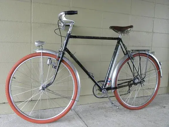

Starting a thread on my new long term project, which I believe is a pre-war French bike.
There seems to be quite a few posts on-line of this bike, i'm assuming the prior owner's postings. In any case i'm kicking off this thread with a few older pictures then showing the progress to where she sits today.
Hope you all enjoy and have some input, I can certainly use all the help I can get with the build.

Thanks everyone. I feel fortunate to have this bike, the Wife was very understanding....

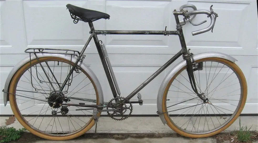

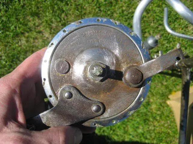

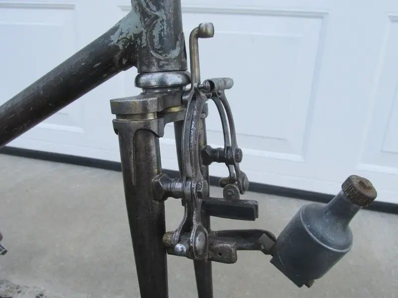

Anyway, rewinding to 2015 the bike turned up at a swap meet in the eastern US, partially assembled. Apparently the bike was imported from France around this time.
I'm including a number of photos from the swap meet that I found on-line.

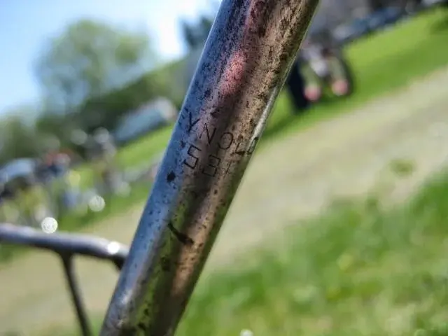

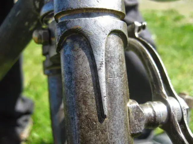

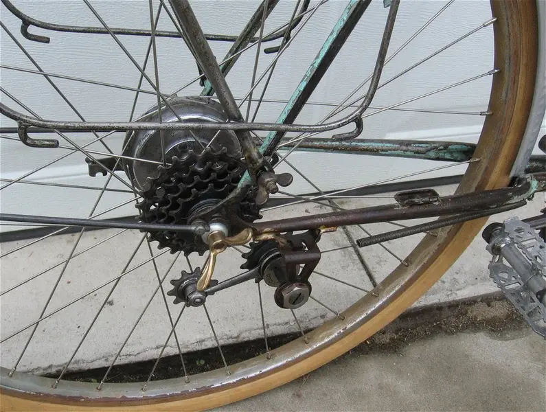

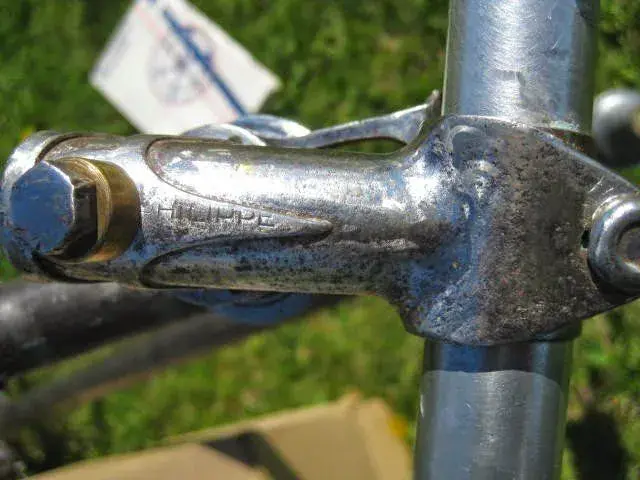

From these it's easy to see that most of the frame and fork are 531, I suspect the chainstays are Rubis like similar French bikes from this time. The hubs are Maxi (pre Maxi-Car) with a very cool rear drum brake. Cyclo Rosa rings, Cyclo rear derailleur, 4 speed Cyclo free wheel. Jaey Brakes, steel Philppe stem, Tank pedals, early Erpelding brake levers, and the beautiful Ideale saddle.
